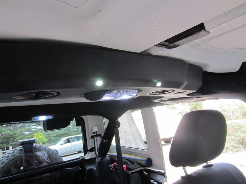

I did the LED dome (front and rear) replacement, and while an improvement, the front dome light points down and doesn't really throw the light where you need it.
Superbright makes a "bolt" LED light that has a spherical lens that disperses the light 120 degrees, and throws 25 lumens. A picture of the bolt light is below; they're $5 each.

I installed two of these lights in the angled area of the sound bar that faces forward; spacing them so that they would cast light over the driver's and passenger's shoulder. I drilled 3/8" holes and then used a rat tail file to get to just the right size (about 7/16"). I wired them into the dome light circuitry, both left and right, and they come on when the door is opened and fade out when the dome light goes out. The left light also comes on when you hit the left dome light button and the same for the right side. It's a big improvement because it puts the light where you need it; I can now read a map or even find items I've dropped in the footwell.

Since I usually sleep in the back of the JKUR when I'm camping, I also wanted a light that faced to the rear and that I could turn on or off without having to reach for the ignition key. I installed a single bolt light and a micro-toggle switch in the rear of the sound bar that is wired to constant power.

Longer answer: I set up an auxillary fuse box under the hood for all of my electrical accessories. https://www.jk-forum.com/forums/jk-s...-panel-266459/
For the rear light, the constant power wire runs through the firewall hole on the drivers side, up the A pillar, along the roll bar and into the sound bar and to the switch and the light.
I took off the sound bar to drill the holes, run the wire and make the connections for the lights. It might be possible to do it without taking the sound bar down, but you'd have to be good at threading the needle to get the wires where they need to be.
I also did the polyfill around the soundbar speakers at the same time, so it made sense to just take it off and do it without any gymnastics and odd positions.
Having used them for a few days now, you could get away with a single light facing forward, but the 2 lights are pretty nice if you really want to see what's in the front compartment.
