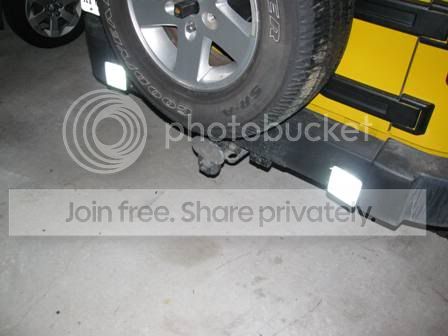

Attachment 234372
The little guys are made by Blazer (part# XT860) and I found my first two sets at Wally-World for $10 each (clearance). They come with 55 watt H3 bulbs, (swapped for 100 watters) and the seams need to be siliconed. I still need to move them, so I don't have to buy any more. The last set was bought on eBay for $20. They're 4 1/2" W x 1 1/2" H x 2 5/8" D, have glass lenses and metal bodies. They are one of the best mods I have done, but I wouldn't mount them very high up. My KC's suck as back-up lights, but are good work lights. If I had a stock bumper, I would simply cut out a 1.5" x 4.5" hole and flush mount them. I have them wired to come on with the back-up lights only, through a relay.

EDIT: I just saw in your profile that it's custom. I made the original post from my smart(?)phone and couldn't see the profile. Anyway, very nice!
