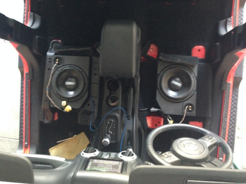

Subwoofer - maybe the most important addition when you are trying to get great sound. Again it needs power like the amps above are able to do. You can build a cheap box and put it in the back of the Jeep. Problem is, it is a magnet for thieves and it takes up a ton of room. A couple years ago we started making enclosures that will go under the front seats and hold a 10" sub. By putting them up front, they are stealth (you cant see them with the top off), The put out a ton of bass and you can hear and feel them with the top off. Here is what we made - I have these in my Jeep, 2 10" subs powered by 1200w. It makes for a pretty good sound system in a really crappy acoustic environment.

Underseat Sub
I would really like to go the underseat sub route. Unfortunately, I have a 2 door and haven't been able to find an underseat sub available for the 2 door. Apparently they have different brackets underneath the seats. Does anyone know of a way to get subs under the seats in a 2 door? I'm looking at the JL Stealthbox, but would love to avoid spending 700.
