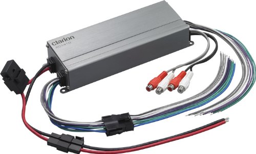

Amp
Amazon.com : Clarion Mobile Electronics XC1410 D-Class 4-Channel Amplifier : Vehicle Multi Channel Amplifiers : Car Electronics
50W x 4 - compact size, hoping to install in factory location. Anyone have this in factory amp location? Edit: Doesn't fit stock location...too deep.

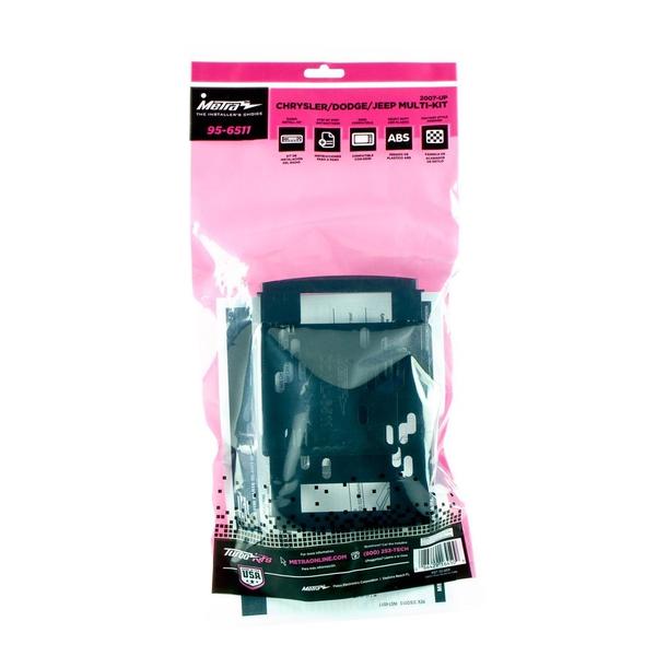

Dash Kit
Amazon.com : Metra 95-6511 Chrysler/Jeep DDIN 2007 Dash Kit : Vehicle Audio Video Accessories And Parts : Car Electronics
Amazon warns it won't fit my 14 but package says 2007 up. Is the Scosche better? I may just get both and fiddle with it. I want it to look good.

I wouldn't use that little amp. Use the new headunits power to power your speakers, and if you don't like it, install new speakers.
I had the base stereo also. I installed 4 néw speakers. Sound improved dramatically! (Poly fill in soundbar too)
Then I installed a née pioneer head unit, sound improved even more!
Then I added a mono amp and sub, sound quality is now amazing.
I wouldn't mess with that 50wx4 amp unless you really want it in there. But you don't need it.

I've already replaced the sound bar speakers (and poly filled) and plan on doing the fronts if needed. I'll give the amp a shot as 50W > 18W. I'm not looking for anything fancy I just want to make some improvements and get a USB. Once everything is installed, swapping out any one component in the future will be easy. Thanks for the tip on the wired remote but this HU doesn't have a rear aux so I won't make that mistake.
