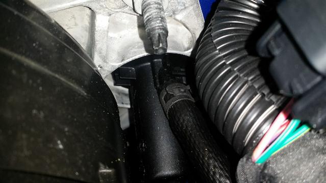

Is this where the grommet should be because on mine it a big plastic clip.

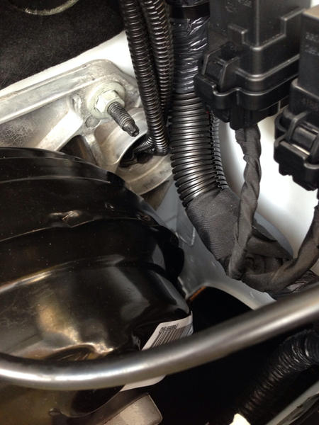

Here's one more:
Sent from my NSA monitoring device... Using the JK-Forum app

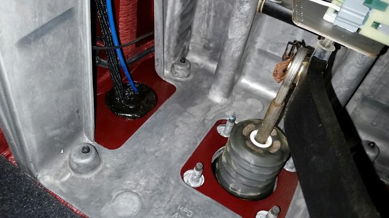

Attachment 579372
This is a picture from inside the cab next to the brake pedal. I have my sPod cable and onboard air gauge tube running through it.
