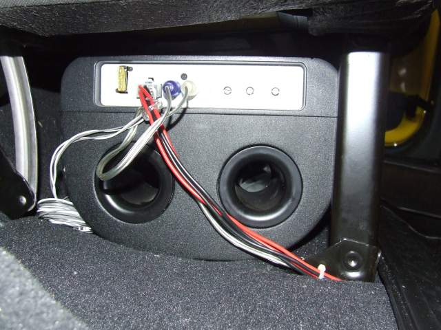

My amp and sub is all one one unit. Blaupunkt Thb 210A. Under the rear passenger seat.
