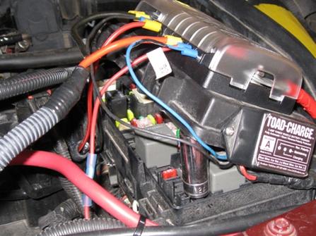

Old Nov 1, 2008 | 03:17 PM
kb7our's Avatar
Joined: May 2007
Posts: 258
Originally Posted by Monty-
any pics of your setup?
Pics as promised.

Old Nov 2, 2008 | 04:07 PM
TexsDream77's Avatar
Joined: Nov 2007
Posts: 1,595
From: Rhode Island
Originally Posted by kb7our
Pics as promised.
That is the exact same location and parts that I used in mine. Too funny. Blue Sea makes some awsome electrical stuff. I don't know why more offroad people don't use marine stuff. I have for years... even before working for a marine dealer
