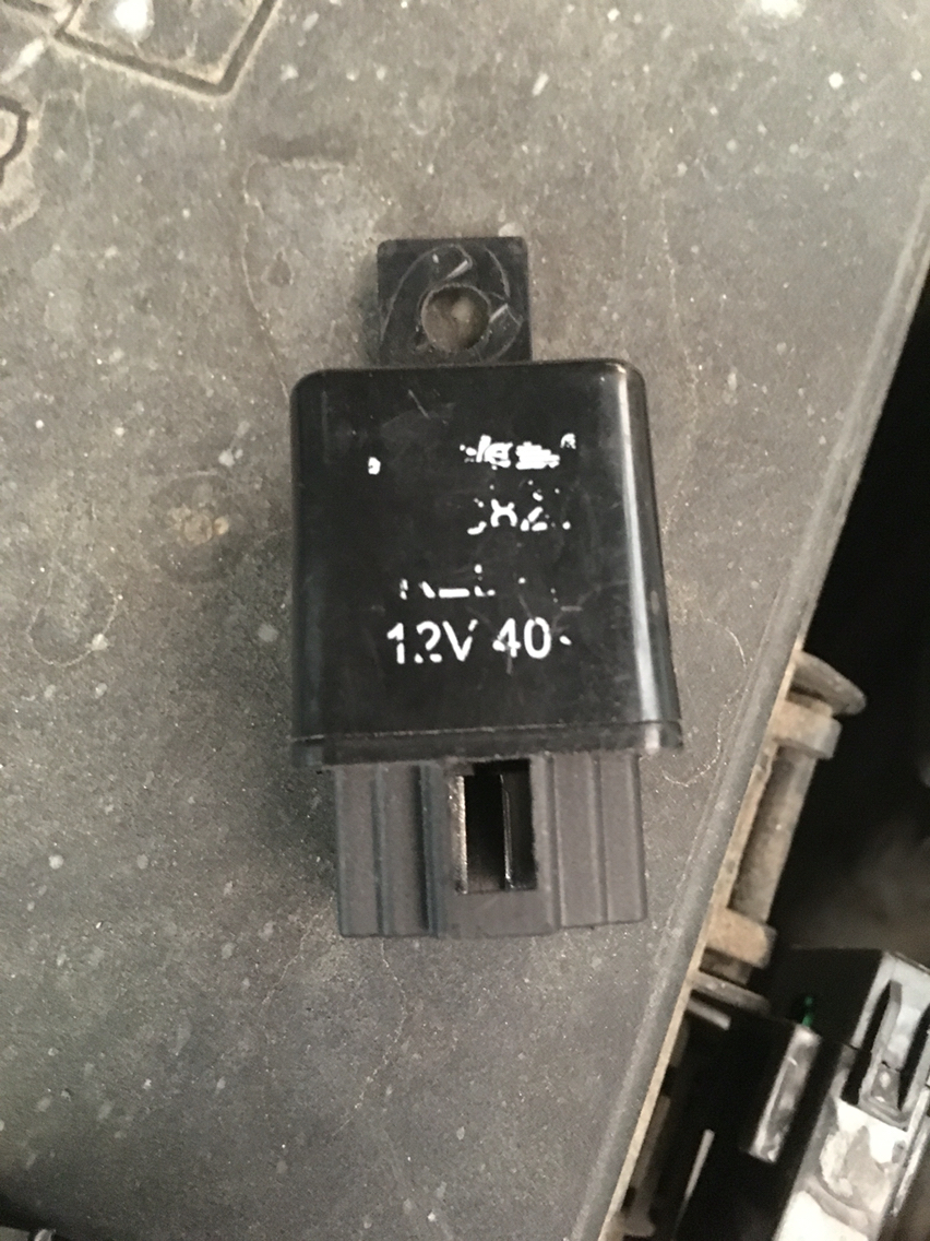

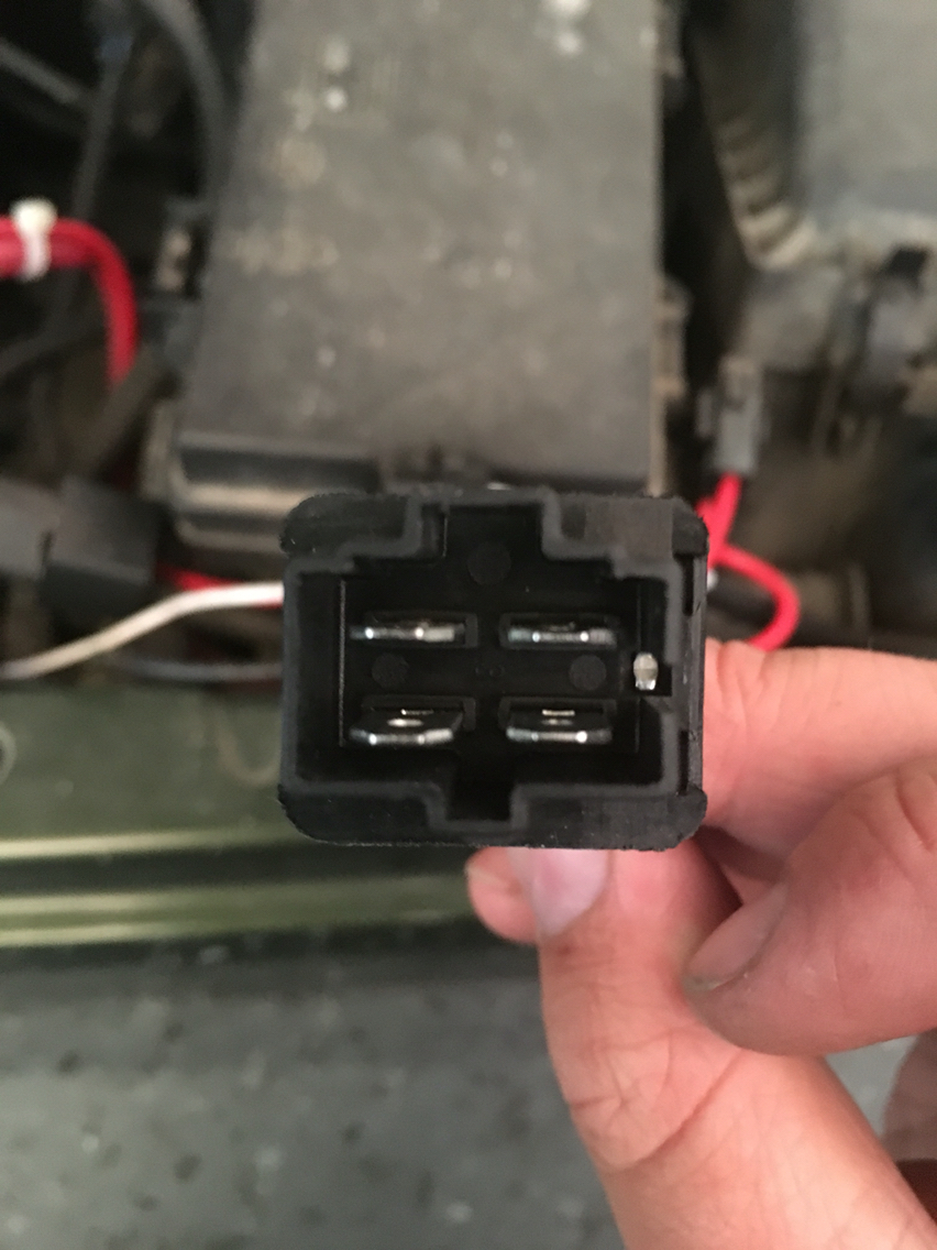

So after a while I flipped the switch just out of curiosity. It came on for a few seconds with a high pitched buzzing sound. Haven't got the time to dig into it recently, but I did find the relay online.
Sorry for the late response, forgot to look at my notifications
Old Jun 20, 2016 | 05:56 PM
biggreenjku's Avatar
Joined: May 2016
Posts: 26
From: KC, MO
Some pictures...
Relay said "12v 40 amp"
ID:	650287   Click image for larger version
