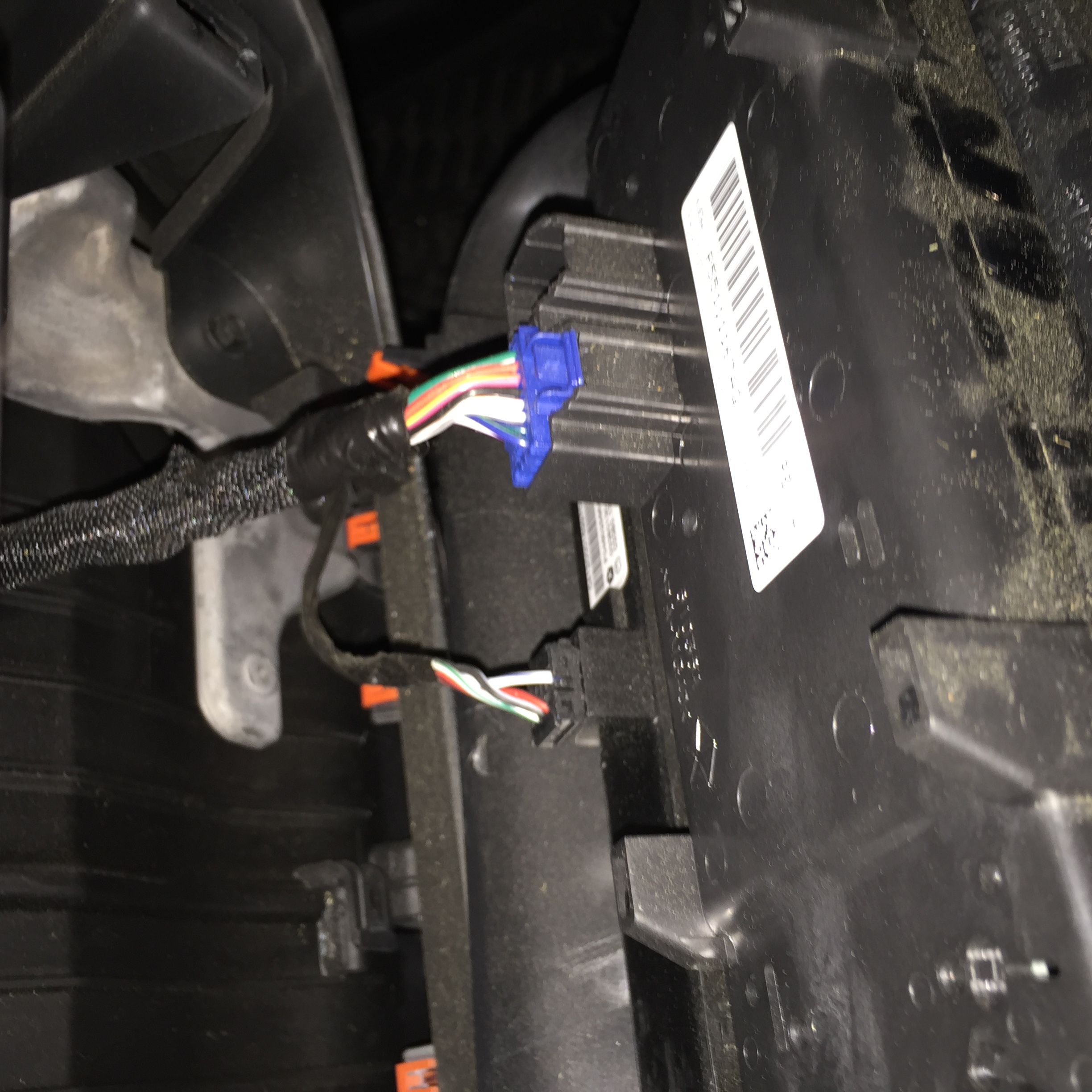

I've heard the 2012+ have an electronic HVAC control module. Would this be plug and play if that got fried?

It does and its easy to get out. 4 Bolts to Pull the Cowl then pull the panel that clips in. I messed with it trying to get lighted power for my locker switches.
