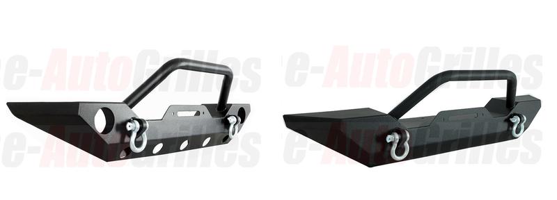

I'm looking at two front bumpers except one has OEM fog light cutouts and the other is $70 cheaper. Do they make bumper mounted fog lights that use the OEM fog light cabling? Something I can plug-n-play?
I'm comfortable enough splicing and extending the OEM fog light wiring to fit the bumper with cutouts, but don't want to run wiring through my car and install on/off switches. Was looking at some KC HiLites Fog Lights but I can't tell if they can just plug in or like some owners install the wiring and switches.
Bumpers in question:

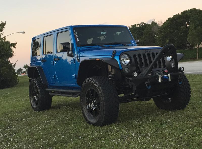

If it helps your decision, here's mine with the Inspired Revolvers. I can snap a pic of the cables tomorrow if you want but I have plenty of cable and plugged right into my OEM plugs.
I chose this style for the simple fact I don't have enough toys to run a sPod or similar. These critters light up the drive to my house and have taken a whoopin.
Since I'm local to Inspired, I had an issue with one light...it was replaced on the spot. I'm sure it's just as easy not being local...just shipping.
