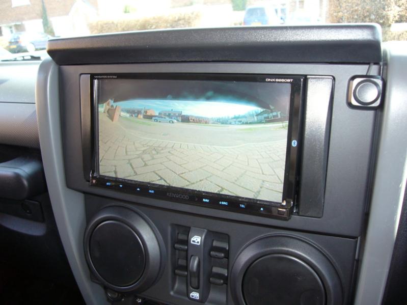

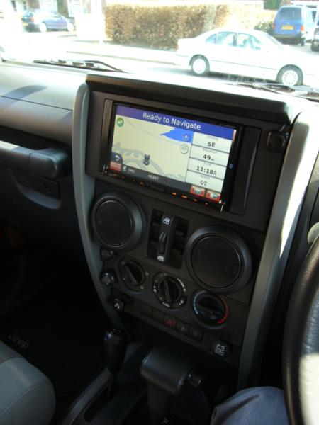

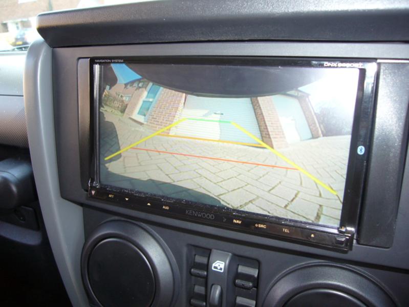

I have the Kenwood DNX 9260BT which is the UK version of the DNX 9960. Removable faceplate, front and rear cams, iPod link, Garmin sat nav and DVD on the go all you need to do is ground a wire to get the DVD to work on the go. Faceplate tilts back so might avoid the sun.
