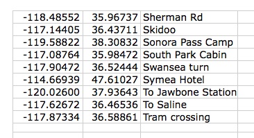

When you have your list of waypoints, you enter them in three columns in the spreadsheet as shown in the picture below; left to right are longitude, latitude, and a name for the waypoint. For the 430n to understand the values, here in the western hemisphere, the longitude values are expressed as negative values, while eastern hemisphere waypoints don’t require a symbol. I save the spreadsheet as a csv file called “garmin.csv” on my desktop.

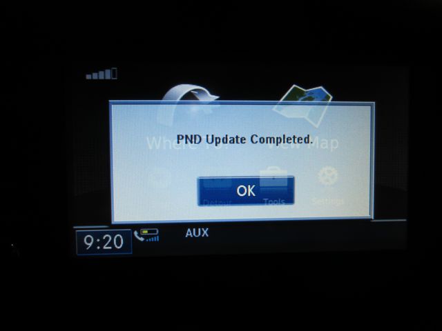

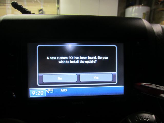

Head for the JK, turn on the 430n and insert the USB stick in the USB slot. The file should upload automatically (pictures below) and the waypoints will be stored as Custom POIs. If you already have custom POIs entered, the unit will require you to replace the entire list. So I just keep adding to my garmin.csv file and replace the Custom POIs for each trip.

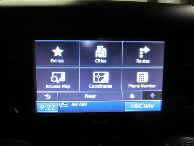

To get to your waypoint POIs, in the navigation window, hit the “Where To?” on the screen, then the down arrow in the lower right corner, then hit “Extras”. This takes you to the next screen, which should display “Custom POIs”; hit that.
POIs will be displayed in an order based on proximity, but you can also get to them by the SPELL function at the bottom of the screen. Pick one and then it’s just like any other address; the map will come up and you can hit “Go!” for the turn-by-turn directions to your waypoint.
