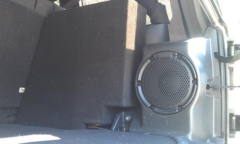

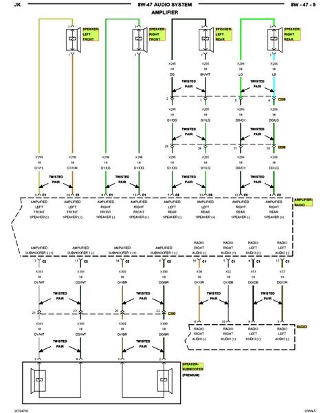

I kept the factory sub, and added a 12 with a loc connected to the sub speaker wire after the factory amp. If you connect the loc before the amp, you won't have controls like volume, eq, unless you have a much more expensive unit. I have the infinity wiring diagram in my album if you need it.
Yes please send me the diagram! So you were able to keep the existing factory sub and add an additional? That is exactly what I want to do
Old May 14, 2012 | 06:41 PM
DKehler's Avatar
Posts: 914
Likes: 6
From: Las Vegas, NV
I found the speaker wiring going to the factory sub on the passenger side along the floor. Just spliced in my LOC, powered an amp and hooked up my new sub. The only problem I had was the first LOC I bought wouldn't handle the power from the factory sub and it gave zero output. I contacted the manufacturer ( PAC ) and they told me the right one and it works great now.
