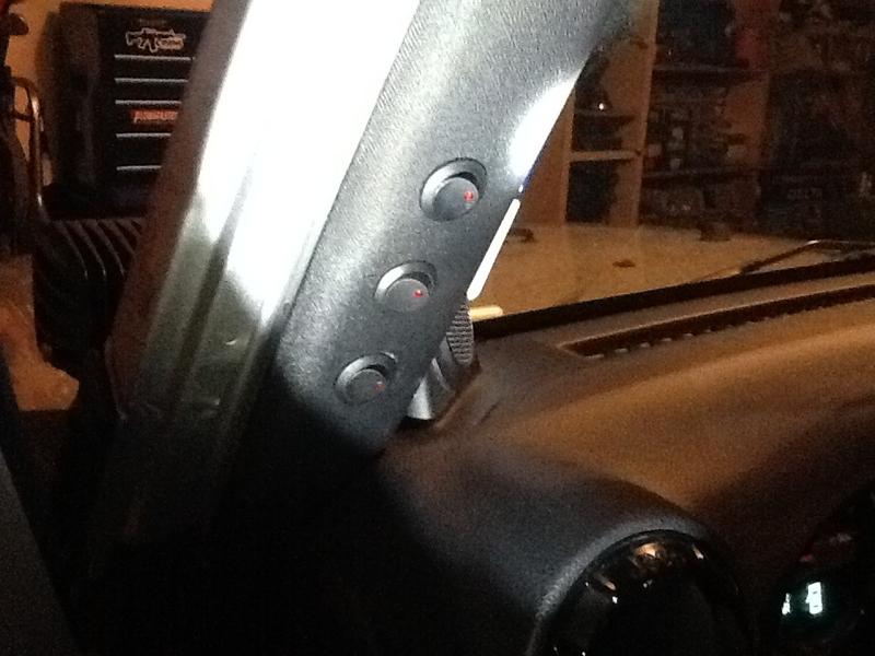

There is a ton of room behind the plastic piece over the A-pillar to mount a switch. There are pretty clear cut instructions included with the lights on how to use the plug and play harness.

This is where I located my switches...
