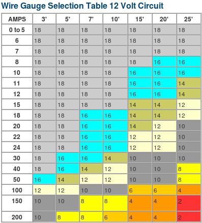

Finally installing my ACE rear bumper and I need to know the gauge of the back up lights wiring.
Thanks in advance.
Use this diagram.
Divide wattage of light by 12 and you will see what amps you are running
