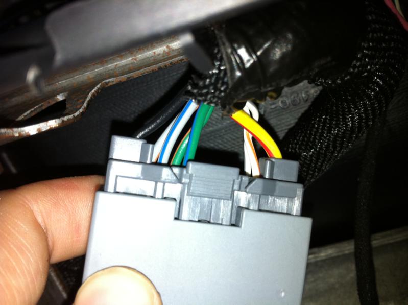

I do think the problem is the tightness of the grey... I mess with those wires and it comes on and off/ right speakers play, no left. Blahhhhh
I can't push this thing together any tighter. All my force into it and it won't budge

Sounds to me like squashed pins at one of the grey connectors. My right speakers didn't work because a single pin didn't make it into the plug and got squashed. I straightened it and was more careful connecting them and everything worked well. The CHR550 plug is a close copy, but not perfectly matched with everything lined up absolutely perfectly. a squashed pin or two would also keep it from snapping together tight.
If that's it, you will want to be be really gentle straightening it as a broken pin would be just as bad...

U are genius. I had about 5 that were bent slightly.
