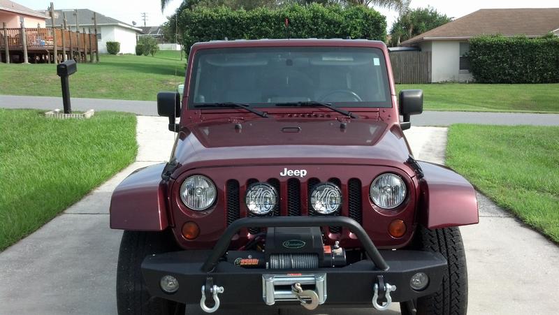

http://www.youtube.com/watch?v=7Rczal0pz6g I installed mine on my bull-bar. It's best to run the wires under the light along the bracket and zip-tie them to the bracket. From there you can go any direction you want. I didn't modify the KC wiring harness. I did cover with wire loom.
