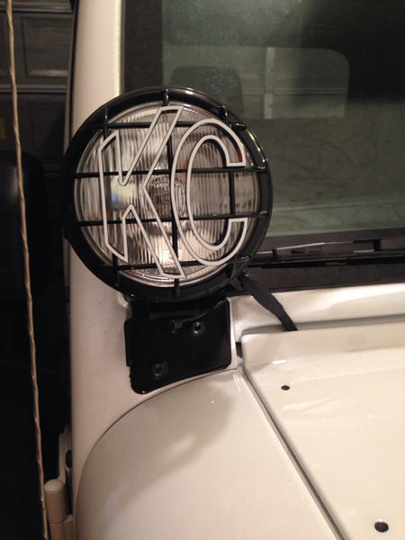

Here is how I have mine set up.

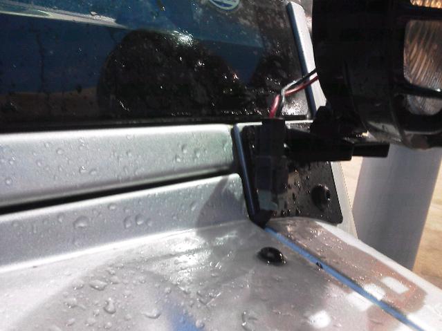

As this set of lights came with free windshield brackets I really assumed the lights would be designed to be mounted on the windshield. It seems that these are much different than the others I have seen however I do plan to make them work somehow. Headed to the store now to find some heat shrink style connectors and I plan to add a little wire and extend the factory connectors enough to go under the cowl. Thanks for the input as I was starting to think I had received some factory defect lights but now see this is normal.
Yea I ran into the same issue. I just took a rubber bicycle tube and covered the connector and zip tied both ends.

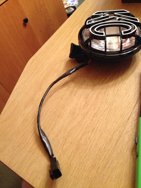

I had the same problem with my kc lights here's some pics of what I did I added 5 inches of wire with butt heat shrink connectors to both sides
ID:	519863   Click image for larger version

Well my OCD side simply could not stand those huge plug in connectors being on the outside and I also cut and spliced in some extra length. I am still using the factory plugs however now have enough slack to tuck them under the cowl.
I used good quality heat shrink butt splices and took my time so hopefully they will work fine. Still trying to finish the install and work out where to mount this relay and also getting through the firewall to interior switch. Maybe tonight I will have them going and thanks again for all the help with this.

[QUOTE="catahoula;3795695"]Here is how I have mine set
Can you say what size yur KC's are? I'm trying to get size perspective-guess @ 6"?
