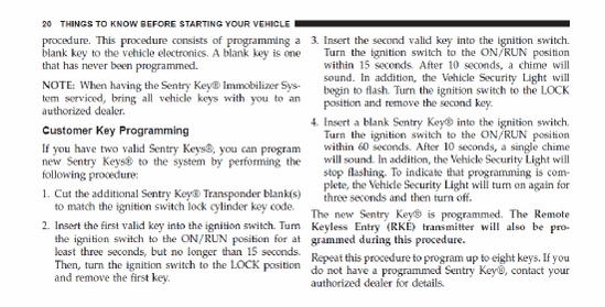

Also, I have a friend that programmed his key by turning the ignition 7x on his ford escape
Jeep have that kinda thing
Old Dec 5, 2014 | 09:02 AM
14Sport's Avatar
Joined: Nov 2013
Posts: 3,703
Likes: 8
From: The Dirty South
Not sure if that was a question but yes. As long as you have 2 chipped keys.
