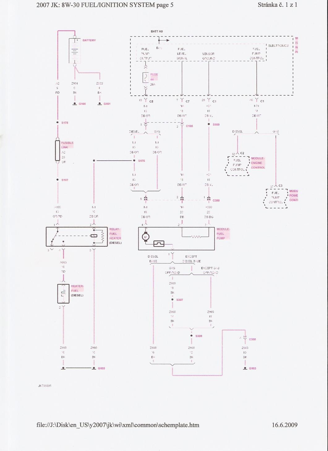

I'm interested in this install. I would like to get more info on which wire and possibly few pics for the first timer. .. Thanks.
Old Jun 15, 2009 | 11:41 PM
tomharley's Avatar
Joined: Jan 2009
Posts: 179
From: Prague. Czech rep.
Sorry for delay.
Just cut the sensor groud wire - Dark blue/yellow or dark blue/orange(+),up to you.
Both wires you will find in the main harness on the right side frame rail.
