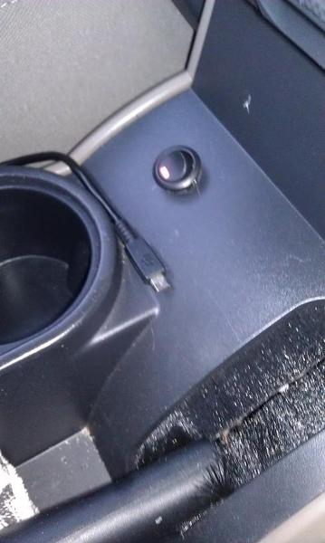

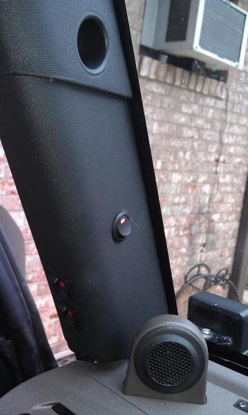

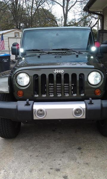

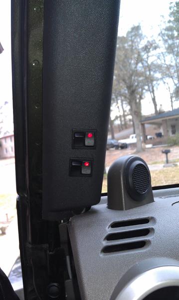

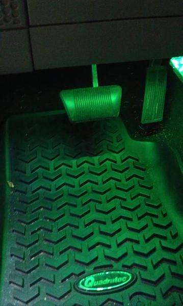

this is what i have installed in my 08 JKU
headlights: Whelen Vortex set in steady on / switchable to strobe
reverse lights: Whelen Vortex set in steady on / swithable to strobe - i added diodes to the hot wire utilizing the reverse wire from the jeep harness, and also a diode from the hot switched wire so as to not get any voltage feedback
both switches have momentary switches next to them to utilize the strobe function
i added green LEDs to the floor for nighttime
the lights mounted on the winshield are Whelen LR11 takedown lights mounted in Radio Shack project boxes -- they are friggin awesome driving lights
the pictures attached are from daytime shots ... i will post night time shots later this week
