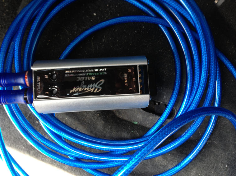

Kicker ZX10Sum8 Summing LOC

You'll need a total of 4 line outs, to feed the inputs of the 4 channel amp, so you'll need to plan that part out. Either (2) 2 channel line out converter, or (1) 4 channel line out converter.
The other thing I'm a little unsure of is how you're going to get an input signal to your Mono sub amp, since I'm unfamiliar with the components you're getting. Some amplifiers as in your 4 channel amp have a Sub RCA output connector. So it takes the Line ins, you're connecting to it, then sums those signals together, adds a low pass filter, and then you have a sub output to run to your input of the sub amp. You could also buy a couple RCA Y adapters, so you can split the L/R inputs that are feeding your four channel amp and connect them at the same time to the RCA inputs on your sub amp. So you'll need to figure out a way to feed an input to your sub amp.
"Kicker ZX10Sum8 Summing LOC"
Without a link, I'm not sure what that is or why you would need it. People are always posting Brand names and model numbers of audio components all the time and expect everyone to know what every part made by hundreds of companies does. I don't know that kind of stuff, I just know what needs to be done and what a particular component needs to do for me to do it.

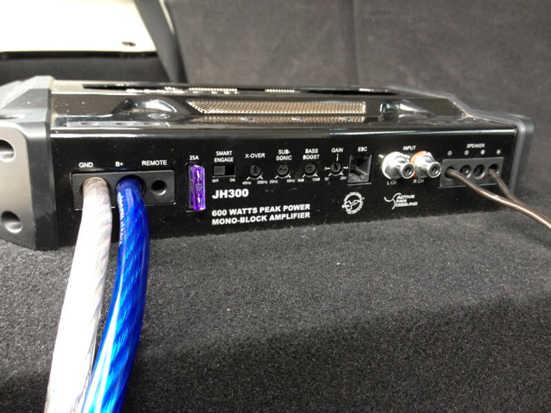

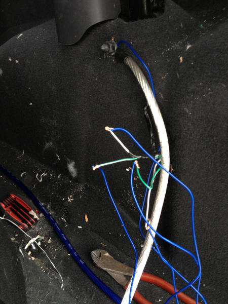

Help I connected the loc to the rear speaker wire and my amp doesn't have power what about the remote wire
What's ur number ill call u

Your amp doesn't have power because you need to connect a switched power wire to that "remote" connection. This is all in the owners manual of your amp. Please trying reading that before considering to call me.

I connected to to the yellow and red constant power 12v and it still didn't work called future shop there gonna have a look at it
That said it can't be connected to a constant power so I'm gonna try hooking it up to the other cig lighter hopefully that works either way there gonna look at it next weekend
