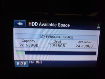

The new size of My Personal Space is 24.68 GB!
Capacity: 26.638 GB
Used: 1.958 GB
Available: 24.680 GB
I have not uploaded any pics or mp3's but 1.958 GB's are already taken by the MyGIG - Hmmm??

Name:	MyGiG My Personal Space Screen.jpg

Obviously, this method requires someone to reinstall/upload all pics and mp3's again.
These steps should work with any 2.5" ATA hard drive, but I'm not sure if the MyGIG QNX [hardware / software] has any partition size limits.
Warning: I need to do more testing to ensure my upgrade properly uploads and plays pics and music. Also need to test if the larger hard drive will interfer with Chrysler software updades.
Until next time, tinker at your own RISK!
