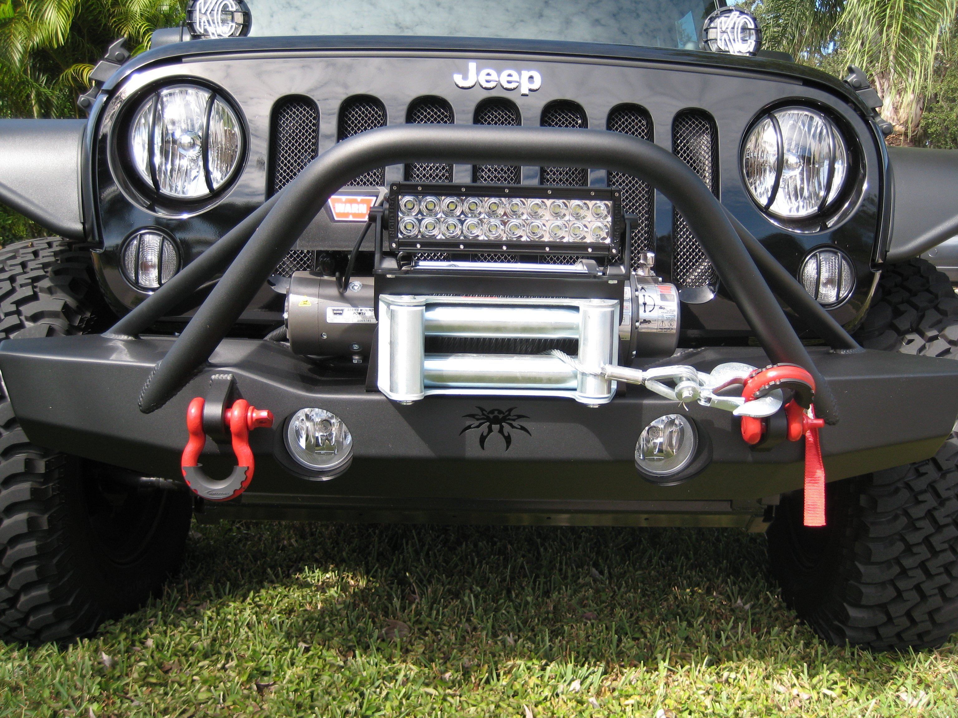

Is this what you're looking for? To mount a light as such? Click image for larger version

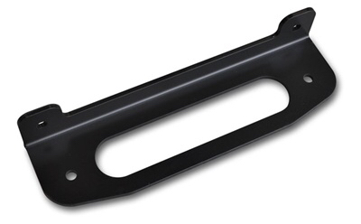

ID:	627804 If so PM me your address! I'll mail you a brand new one still in the box. Once you receive mail me a check for the shipping. I bought my 10" led "E" series rigid light from PSC and got the free mounting bracket. Already had one. Just laying on my bench collecting dust.
This is the bracket I have I can mail you.
http://shop.poisonspyder.com/mobile/...45-28-r10.htm=

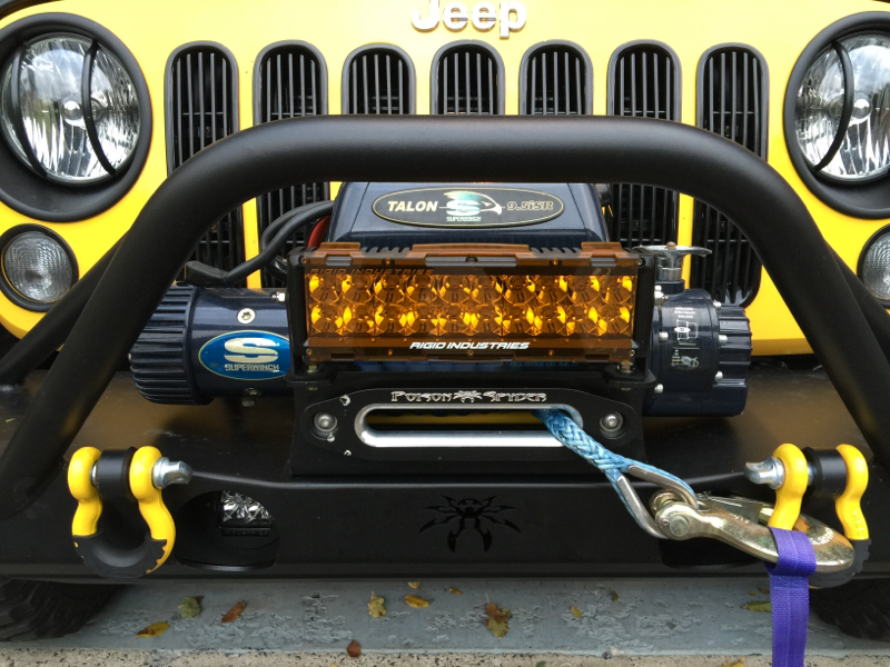

The fairlead mounting holes or the light? If it's a 10" light with 13" mounting holes you may have the light brackets facing the wrong way.

Originally Posted by 14Sport
The fairlead mounting holes or the light? If it a 10" light with 13" mounting holes you may have the light brackets facing the wrong way.

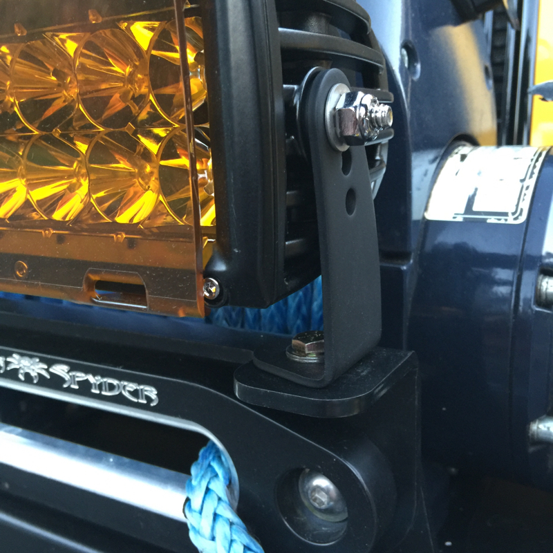

Exactly! The foot of the bracket needs to go back under the light. Took a quick pic of mine. Click image for larger version

Originally Posted by nhk19
Exactly! The foot of the bracket needs to go back under the light. Took a quick pic of mine. <img src="https://www.jk-forum.com/forums/attachment.php?attachmentid=627814"/>
This is the one I have. They face out and can't be reversed.

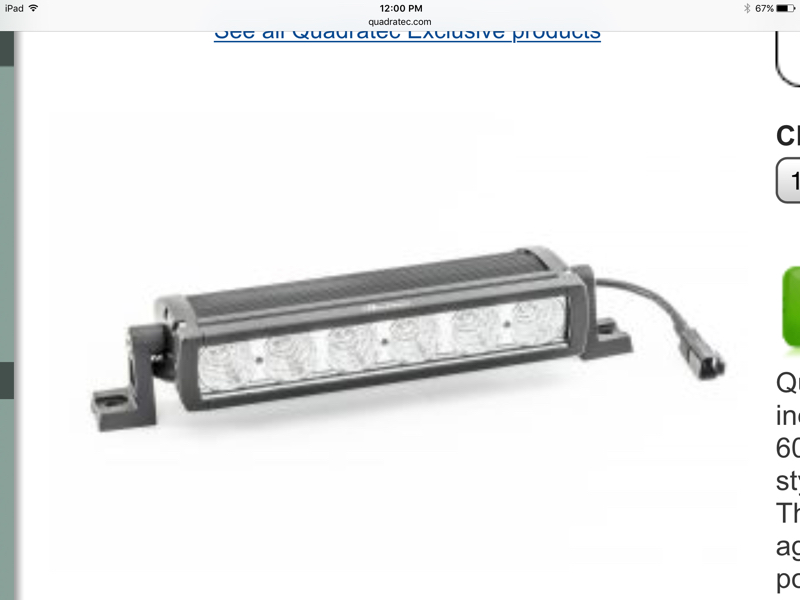

Originally Posted by NCRUBI2012
This is the one I have. They face out and can't be reversed. <img src="https://www.jk-forum.com/forums/attachment.php?attachmentid=627874"/>
I see. Even went on Quadratec's website to get a closer look. The wire mounting point on the light prevents it. You do have a dilemma. Well....if you get a new light the offer stands. I'll send you my bracket. PM if needed. Good luck!
