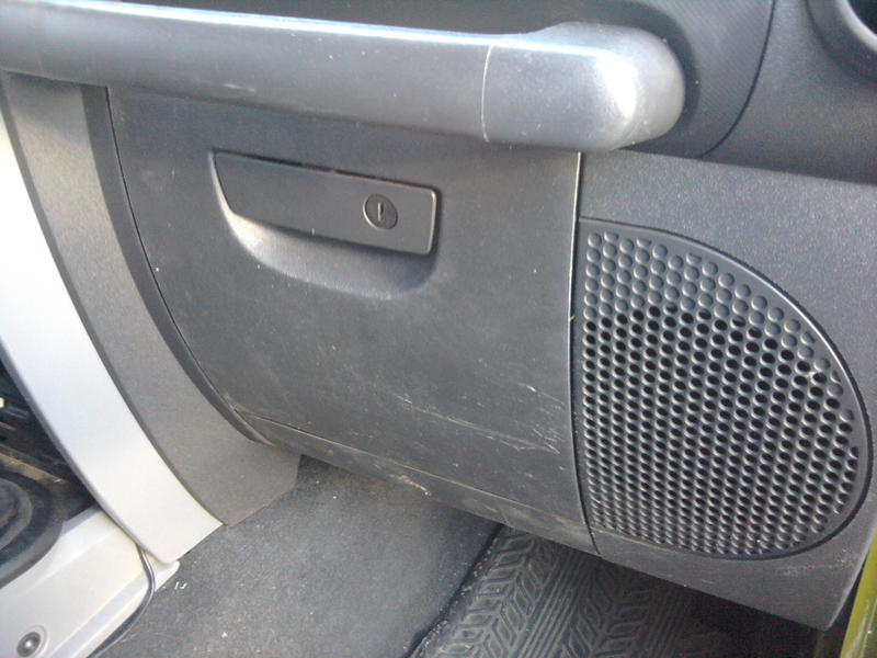

So I was using the Daystar lower dash kit with three Daystar rocker switches to power my (4) 5" pro comp lights, (4) Burner Rock lights and my on board air. The only proplem I was having was when I had the switches turned on and I shifted into 1st gear or 3rd it would turn off my switches. Some of you might know what I am talking about. But finding A suitable place to put my Daystar switches was quite the challange. This is what I came up with.
Name:	2010-12-30 13.47.41.jpg

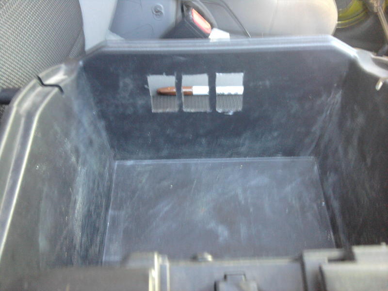

Cut three new holes in the back of the glove box.

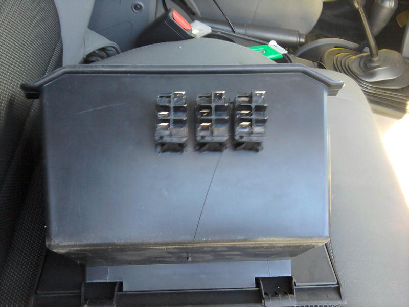

snapped in the switches

wired them up

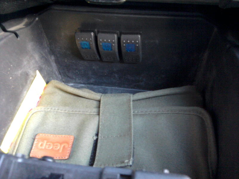

and no more accidental switch bumping

i like it. Perfect place for the not every time switches too free up some room for the more common users.
