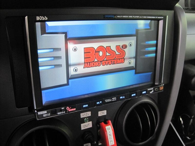

Just finished installing the Boss Audio BV9566Bi I got off Amazon for around $200. If you are on a budget and want an upgrade to the stock non-infinity system I recommend it. AM/FM, DVD/CD, USB, SD card, Ipod hookup and backup camera (not included).

I bought the camera, harness and dash kit. All three added around $60.

Yes it can play DVD's while driving if you ground the emergency brake hook-up wire. It does not need an addition toggle. The unit has a built-in Mic for the bluetooth pairing. I tested it with my wife and she said it sounded the same as the cell-phone (Motorola DroidX).
Here are the part list (forgot to mention antenna adapter):
1 = Boss Audio BV9566Bi
2 = Metra 95-6511 Chrysler/Jeep 2007 DDIN Dask kit
3 = Pyle PLCM10 License plate rear view camera with Lux night vision
4 = Metra 70 6522 Chrysler 2007 harness radio
5 =Metra 40EU10 2002-up VW/BMW/European Vehicle antenna adapter
It took a good six hours to install. I elected to remove the metal bracket for the back of the factory radio. Other forum member used a sawsall to cut the top support. I didn't trust myself with a sawsall inside a plastic dash ;-)

Did you have to cut the dash at all to fit this? How much does it stick out? Looks like it sticks out a good 1/2in... any side pictures would be awesome. If you want to put the stock back in would that be an issue?
