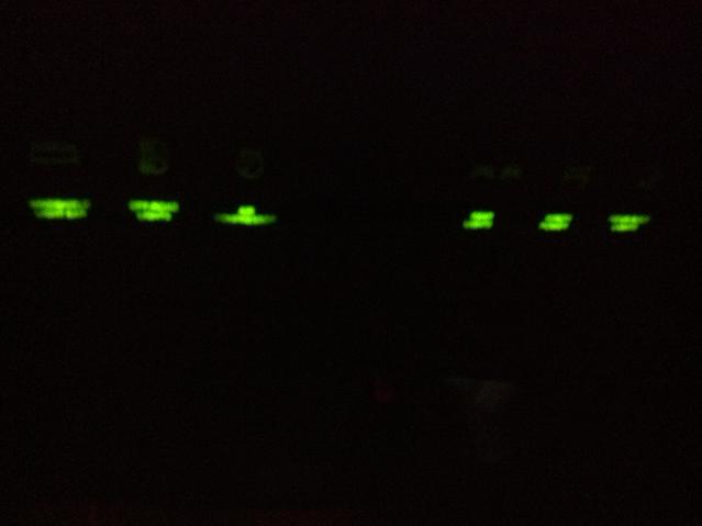

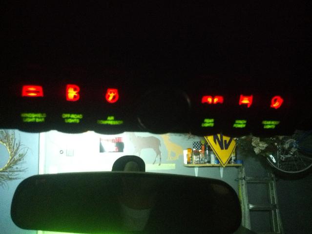

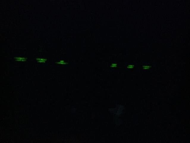

Finally found some time to rewire the spod.
I tapped into the HVAC dimmer switch (the small black plug - orange/gray wire top row second from the right).
First picture is dimmed to the lowest
Second picture is brightest the switches go
Third picture is with every switch activated

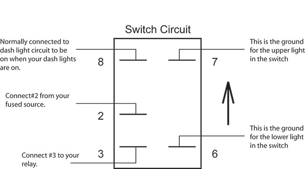

Originally Posted by augichef
Attachment 415009
8=dash light wire
7&6=ground wire
3=accessory/relay
2=power wire
This is how I got mine hooked up..
Should mention for anyone going through the thread, I saw the picture and went along with that wiring diagram. Didn't work for me. Someone posted another wiring setup which worked. 7 & 8 are ground, and 6 is for the dimmer. Rest were correct.
