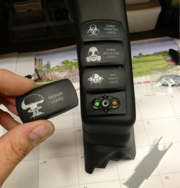

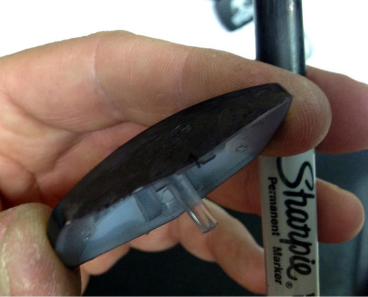

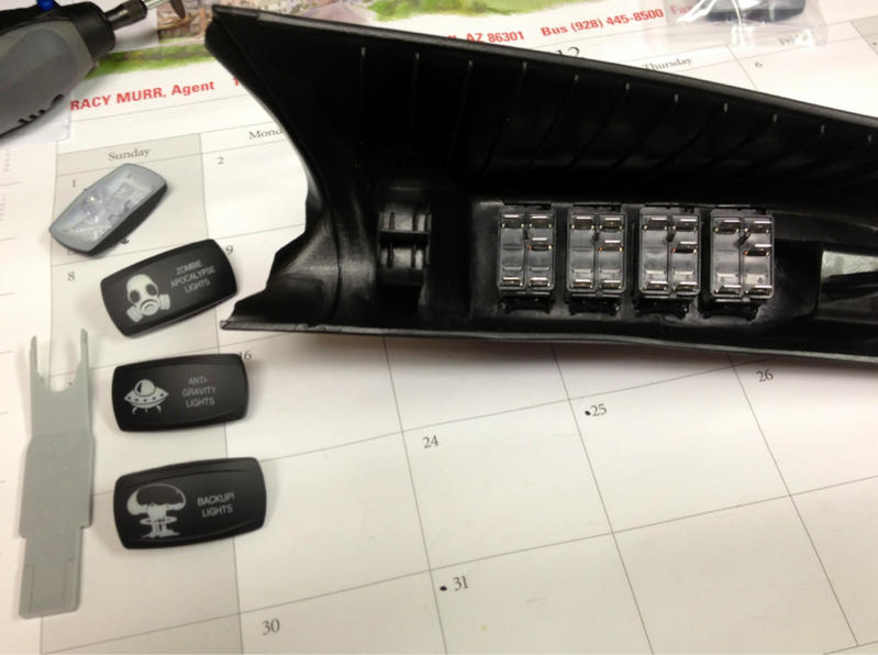

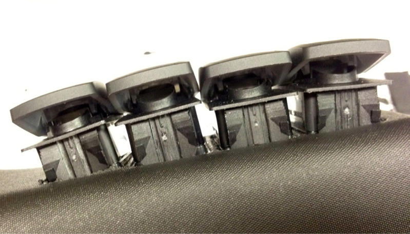

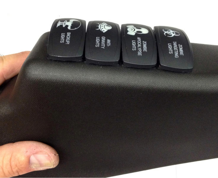

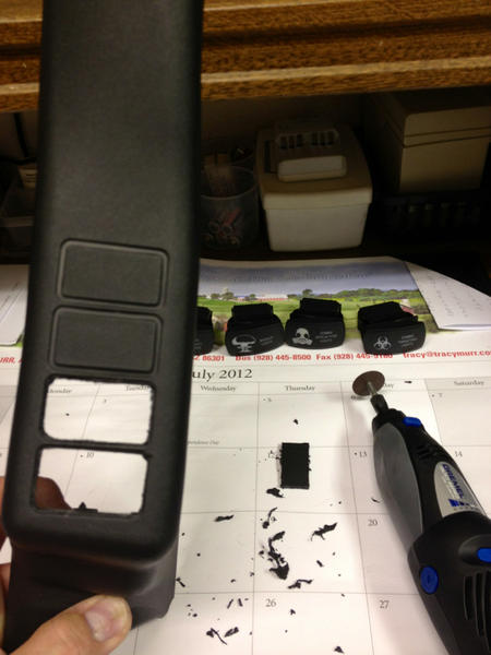

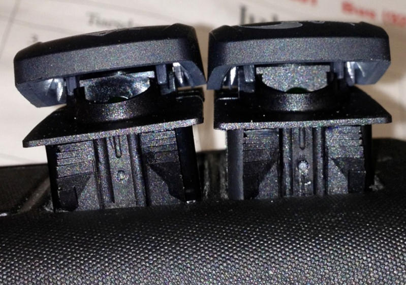

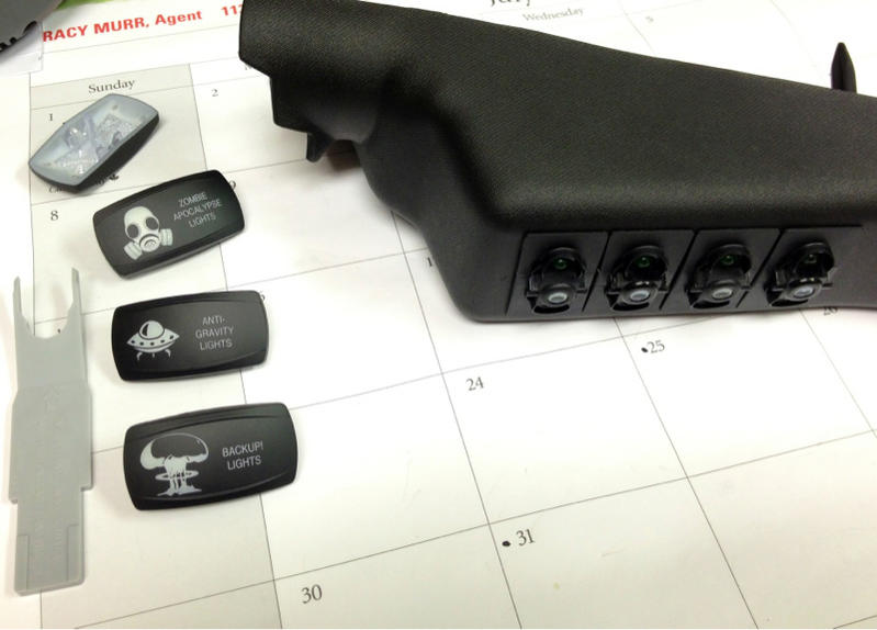

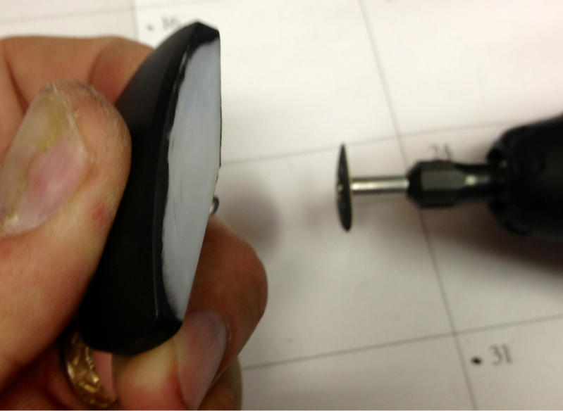

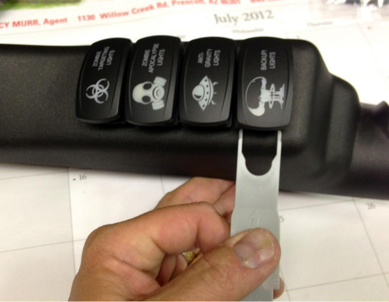

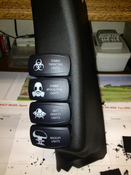

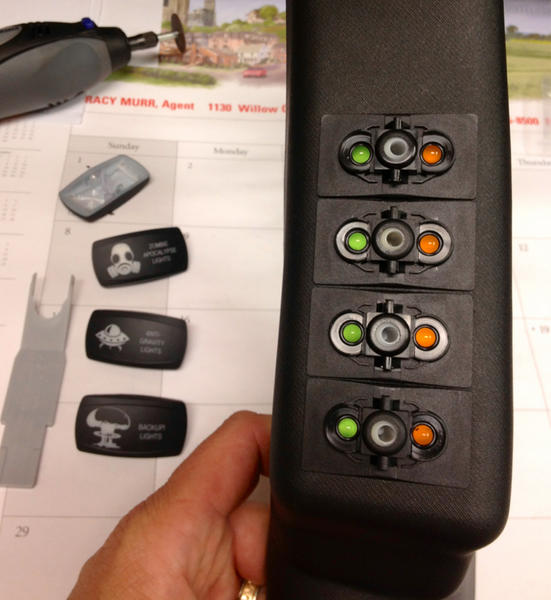

So I got my switch pod and rockers and did a little write up on my steps. Maybe this will help some others. I love my custom switches!
Installing Contura V Laser Etched Rockers In A Rugged Ridge A-Pillar Switch Pod.
Step 1 - Cut openings for switches in switch pod. Use tool of your choice. Score cut lines with an utility knife or if you have a steady hand, a dremel with a small cutting disk makes easy work of it.
Step 2 - Decide the order of your switches from top to bottom. Slide switches partially into openings.
Step 3 - You will observe that the rockers on the switches are thicker in the center so they push on each other not allowing them to properly mount in the openings on switch pod.
Step 4 - Remove the rockers from the switch bases using the special rocker tool.
Step 5 - Push switch bases into switch pod until they click and lock into place. They should be flush and evenly lined up.

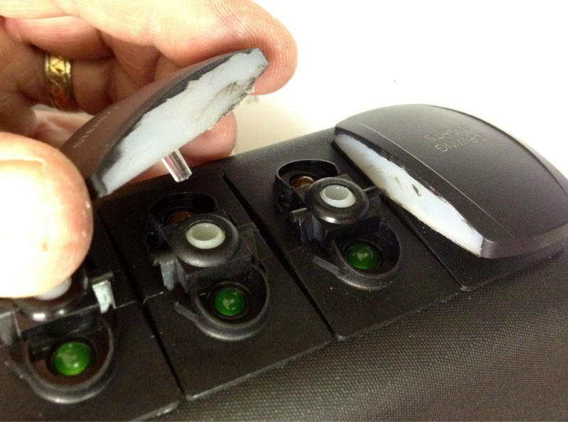

Step 6 - Sand the edges of the rockers down. Focus on the center of the edge of the rocker as this is the area that causes them not to flush mount on top of each other. Starting with your bottom rocker, work your way up one by one. Note that the bottom rocker will only be sanded on its top edge, the two middle rockers with have both edged sanded and the top rocker will only have its bottom edge sanded.
Step 7 - Once you have sanded all edges of the rockers, test fitting as you go along, use a black sharpie marker to color in the white sanded edges.
Step 8 - Pop all your rockers onto switch bases until they click into place. Now your ready to install the switch pod in your Jeep following the Rugged Ridge instructions.

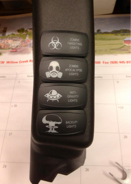

Old Jul 3, 2012 | 05:08 AM
Phunkeydude's Avatar
Posts: 94
From: New Mexico

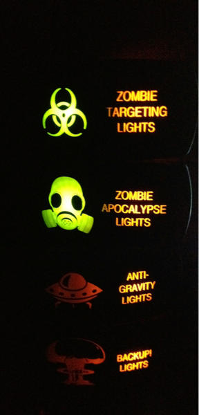

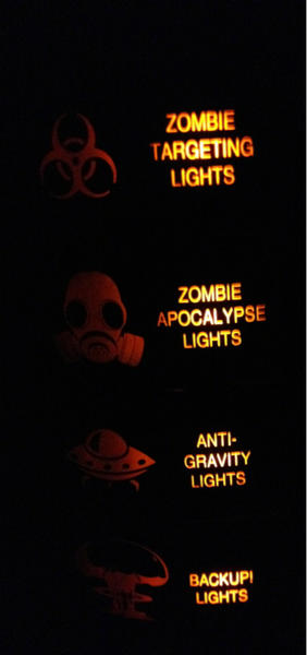

Hooked up. Amber lights up with ignition on. Green lights up when switch is on.
Zombie Targeting = long range spot
Zombie Apocalypse = wide angle floods
Anti-Gravity = Rock lights
Back up! = rear floods

How did you wire up your amber lights? to the fuse box? or off the control for all the interior lights?
Old Jul 3, 2012 | 11:44 AM
ricksjeep10's Avatar
Posts: 629
From: naples,florida
Great job Phunkydude! excellent write up. Will help me when I'm ready to install my lights!
Old Jul 3, 2012 | 01:58 PM
Posts: 94
From: New Mexico
I just used the "12 Volt Power Adapter" wire harness from Q_____tec to tap the aux power plug in the front dash that is ignition switched. Then ran wire over to switches for power. Since the amber LEDs aren't overly bright, I did not need to connect them to a dimmer switch. They don't distract or blind me while on in the dark. The switches come with a wire diagram for the 5 prongs to let you know which prongs are for which LEDs. 2 for amber and 3 for green that control the lights. You can get the rocker switches with several different color combos and configuration.
