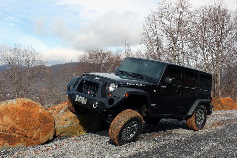

2013 JKUR. Rock Slide bumpers front and rear. The front bumper has two 6" round openings to replace the 4" stock fogs. The rear bumper has two openings for 4" round lights. I would also like some light on the winch fairlead mounting bracket that I have and would also like some on the A-pillars. My options are seemingly endless (if money were not an object). I don't know how the bumper lights are mounted to the bumper. That's issue #1. I guess there are ways to adapt square lights for the round opening.
Someone please give me options. Brands are great and best place to buy. I want all LED, no bulb lights. I have a decent budget, but not thousands $$. I would also like to add crawling lights while I'm at it. They're pretty cheap at $3 each I have read.
Here's the Jeep:

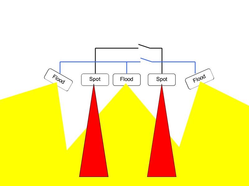

Lights depend on the intended use. You may want to consider this --
If you want the extra lights for relatively slow offroading (and for camping), then wide light spread would be the most efficient.
I’d try and make all the lights -- front, rear & rock lights -- of the same light color.
Front –
The same offroad lights, when installed below or above the drivers’ eye level, behave quite differently.
Lights on the A pillars or lower, cast shadows and ‘hide’ some of the areas which are within the drivers’ view, while lights above eye level -- on a light bar -- illuminate everything that’s within sight.
Rear –
For covering the widest area, at what typically is short range, diffused lights would be the best choice.
Spots are efficient for longer range and fast speed.
At relatively slow speed offroading, they concentrate much light on a small part of the surrounding, and by doing so they reduce visibility outside the circle of light.
The best of all worlds, would be a mix of spots and floods, separately switched, on a lightbar.
Front –
Attachment 572909
Rear –
The best of all worlds, would be a mix of spots and floods, separately switched, on lightbar.
For example:
Attachment 572911
