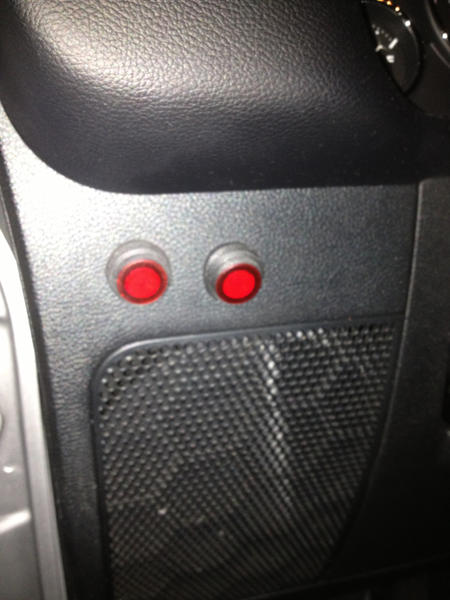

I thought about mounting my rigid switches on the pillar , I'm ended up mounting them above the speaker on lower right of dash and I'm dam glad I did those puppy's are bright !!!! I have two of the round switches that come with rigid harness and when there both on they are bright I think they would bother me on the pillar. I will post a picture of my switch shortly
Old Feb 22, 2013 | 01:48 PM
Butch's Avatar
Posts: 131
From: Michigan
Here's my swithes
