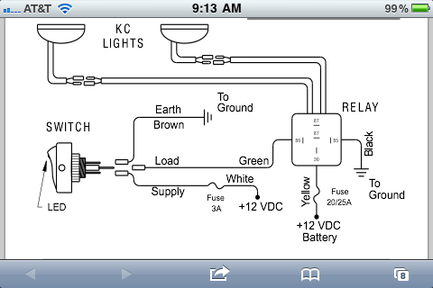

I wired my rock lights according to this set up
Attachment 181129
I hope you don't mind all the questions.
You tried a new fuse, and the lights still didn't work. But, did you check to see if the original fuse, (and even the 2nd fuse), was blown or still good?
And, is the fuse close to the battery, so there is no possibility of a short somewhere between the battery and the fuse?

Questions are fine!! Anything to get my JK back up and running
The rock lights are working.. Both fuses in the rock lights set up are fine. The problem is that the Jeep wouldn't start after installing the rock lights and when I turned the rock lights on, my radio shut off and the interior lights would dim
