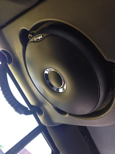

Here are the Polk's installed in the pods.

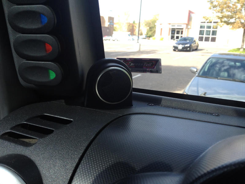

The tweeters that came with the Polk DXi 6500's blend right in with the interior.

You must b a mind reader because I was looking at pretty much the same exact setup 30 minutes ago on Crutchfield website. You answered a lot of my questions I had about the speakers. Two question for you , did you have to do anything special to get the tweeters fit and where did you install the crossovers?

Looks like you used the adaptors that come with the Polks, any issues mounting to the pods or sound bar?
How do the tweeters fit into the tombstones?
Did you have to use the DXI650s in the soundbar due to depth issues or would the standard DXI650 work?
Thanks

The tweeter was simple. There is a metal thingy that comes with the tweeters and it's meant to be used for the flush mount cup. I just bent the tabs on it, put it in backwards inside the tombstone. That way the tweeter cup screws into that thing and the pull tight together holding everything in place. This way there is no cutting on the tombstone and everything is reversible.
