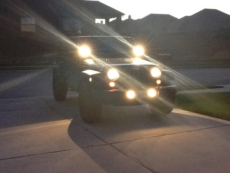

This ought to help light up the trails when we go to Colorado this July. It gets really dark out there... Especially if you are in a new area!

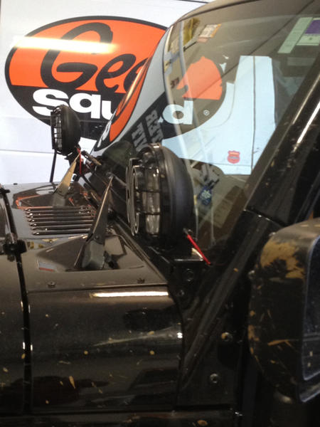

Did you use Daylighters or Slimlines? I was wondering if the Daylighters would hit the windshield as they are so much bigger.
Daylighters work just fine.

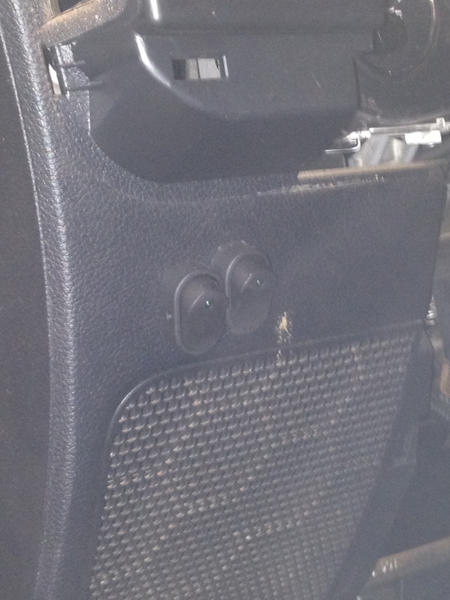

I got these and did the install myself. Took a while for the ones on my bumper, but once I got it figured out it worked great. Drilled 2 holes just left of the steering column...well the gf did as you can tell. Works great though.
