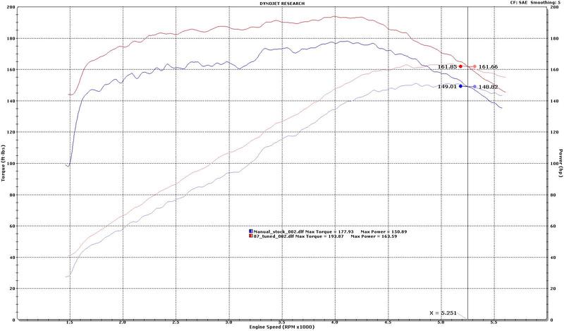

Real Dyno Numbers on a 09 Rubicon with 35 tires and GY MTR Kevlars. 94 Octane in the tank.
87 Octane Tune
RWHP= 120
RW torque= 143
93 Octane Tune
RWHP= 127
RW torque= 153
87 Octane Tune
RWHP= 120
RW torque= 143
93 Octane Tune
RWHP= 127
RW torque= 153
