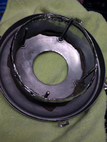

The hella e-codes just weren't cutting it, so I decided to hack up a the factory headlights and drop in projectors. Not being happy with the end result, I put this together.

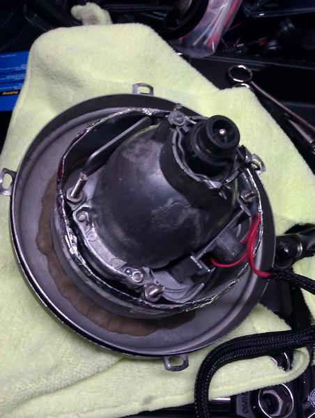

Edit: Two more pics of the rear so you can see how it's mounted. That's a 4" aluminum ducting pipe cut to about 1" attached with a simple epoxy to provide a mounting point for the aluminum tape to seal in the projector unit. The tape was cut off for this picture, so some of it still remains.
