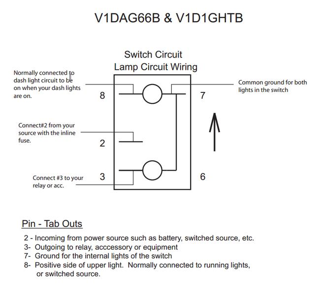

I think this is a diagram of the switch.

Ok it's a dual LED 4 pin switch. It only has 4 pins on it, not 5?
Pin 2 - 12v fused (3A) feed either switched or unswitched.
Pin 3 - connects to pin 85 of the relay for the lights.
Pin 7 - ground.
Pin 8 - dash light circuit. See https://www.jk-forum.com/forums/jk-e...lights-311176/.
The relay should be wired like this.
