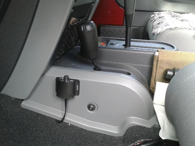

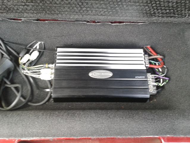

I think it is, it was there when i bought it. It is mounted on the drivers side by shifter. See attached photos. The wire out the bottom is like a phone line and runs to the amp mounted in compartment in cargo area

[QUOTE=rcouch;3193621]I think it is, it was there when i bought it. It is mounted on the drivers side by shifter. See attached photos. The wire out the bottom is like a phone line and runs to the amp mounted in compartment in cargo area
Something like that is impossible to troubleshoot long distance. I would disconnect the sub and see what happens. If the head works, then the problem is in the aux volume or wiring to the sub. I can't tell the gauge size of the wire to the sub but if it's too small you may be trying to pull too much power through that wire and that will do it.
Try dial down the bass to see what happens.

If the head unit works okay then I'd rip out the aux control wiring and let the head control it. You might want to look for shorts or undersized wires between the head and sub, especially at the amp. That rat's nest looks a bit sloppy.

Sorry about pic to the mess of wires on the left is remote for winch stereo wiring is pretty neat
