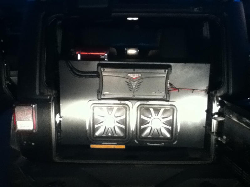

I do have to say there is a difference in the infinity and non.. I have the non and my sound bar has full range. My buddy has the infinity and the sound bar only has higher frequencies. and I'm pretty sure this is all separated through the amp not the headunit as the headunit is the same in me and my buddies. I have replaced all my mids with kickers as well as added 2 12 inch L7s and a zx1500 watt amp and a new headunit. (all In and behind the backseat of a 2012 2 door)

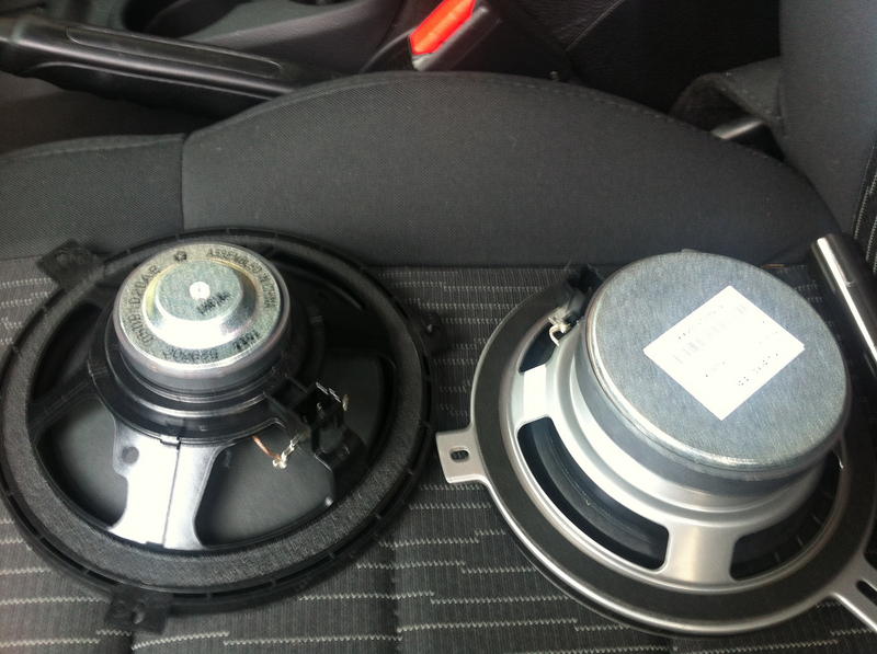

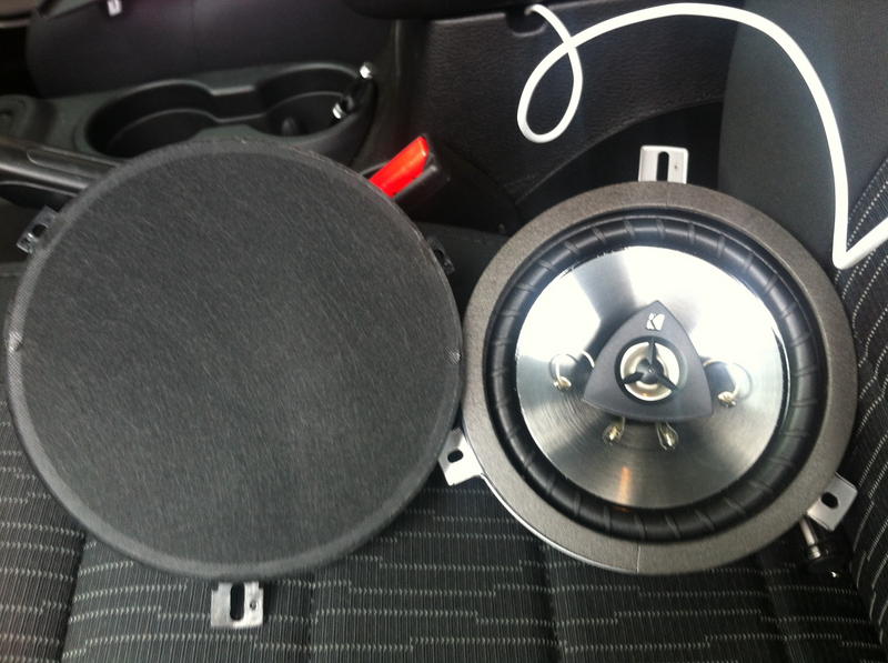

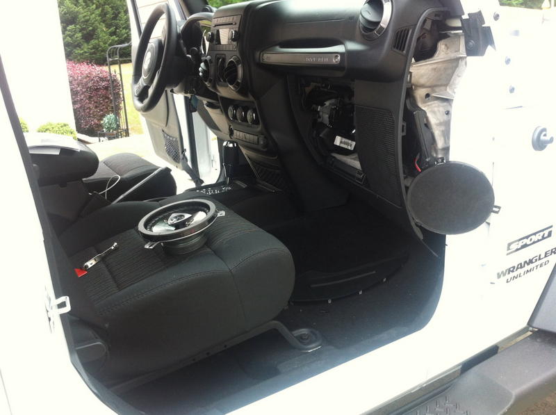

I just replaced my soundbar and fronts with the Kicker Mopar replacements. I had the non-infinity system with standard Sirius HU (not the 430 or 730) and I can verify that highs are sent to all speakers. That leads me to believe the dash tweeters have their own built-in crossovers. Anyway, for the $65 I paid per pair off eBay for the Mopar Kickers, the difference was huge. I replaced them one at a time and all of a sudden I had clear high-hats and cymbals in each, lots more bass and clear mids. I'm sure there are better speakers but for the money this is the best deal and a big improvement on sound quality. Install was easy for soundbar but a PITA for the dash. I found taking the front doors off made it a bit easier. Here's pictures of the stock vs. kickers.

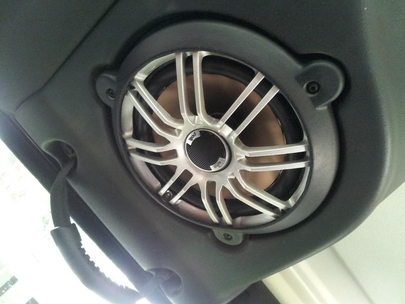

Replaced my Sound bar speakers with Polk Audio marine grade as well. I didn't like the install with just the speaker alone so I went ahead and chopped the factory cover to make it a ring so it looks more OEM.
I think this is the passenger side one. Comparatively, just the speaker replacement alone is a huge step up in sound quality.
