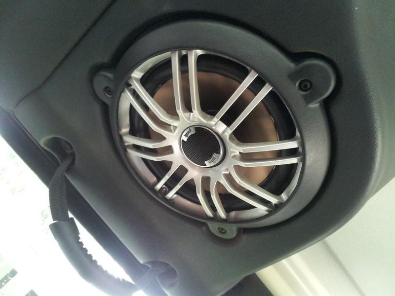

Originally Posted by Bucko
Replaced my Sound bar speakers with Polk Audio marine grade as well. I didn't like the install with just the speaker alone so I went ahead and chopped the factory cover to make it a ring so it looks more OEM.
Attachment 415872
I think this is the passenger side one. Comparatively, just the speaker replacement alone is a huge step up in sound quality.
I really like the way you installed the speakers in your soundbar. I also installed some polks and I am going to try your trick to dress up teh install. It looks fantastic!
