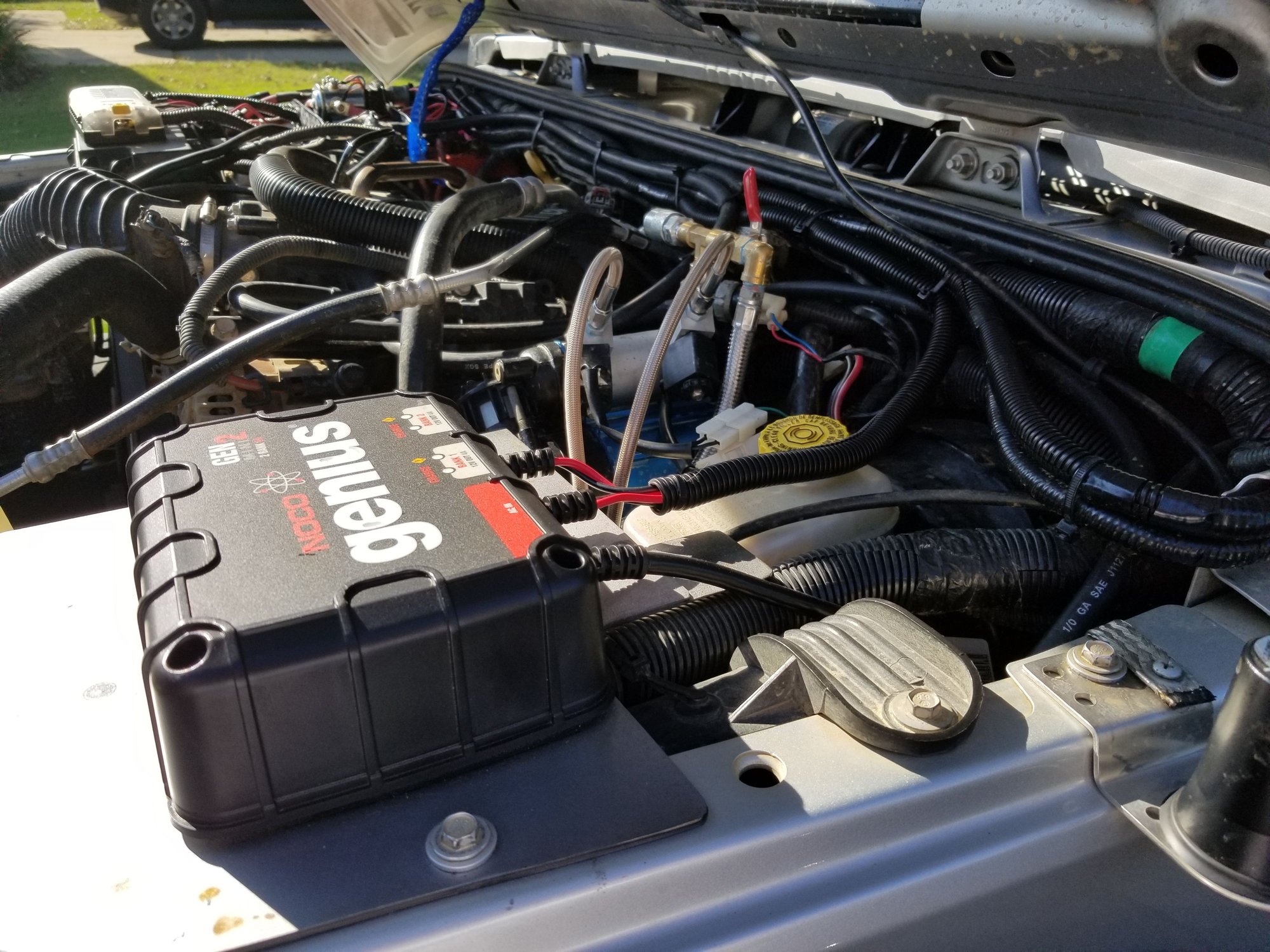

I think the best option is to have both on and off-vehicle panels. My plan is 100W on the roof to maintain my AGM batteries with a PROPER charge at 14.7V-14.9V (e.g. above the JK's 14.4V alternator output) plus power ham radios while the engine is off. Then the portable panels for when I am overlanding.
If people want to run rigid panels, then the AM Solar Z brackets are the way to go. They let you tilt your panels, but allow you to secure them while flat and underway.
Edit: slightly off topic, but for the record I have a Noco Genius onboard charge controller to maintain the AGM batteries; the stock JK alternator just can't keep up with them.
