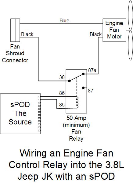

Originally Posted by beeks1021
I have a question for your negative comment about it not turning off items well.
So for me to turn off my lights and for example an air compressor the jeep has to be turned off to shut that item off? When I hit the switch from on to off it dosnt turn it off? Maybe I misunderstood it.
Thanks
BK
I think he meant its primary function it to turn things on and then off, not to turn something off that is on by default. Turning the switch off will turn off whatever accesssory it powers, but it's hard to wire the spod to turn something off that's always on by default such as the fan. Hard to explain, but to answer your question the spod will turn anything off that it turns on.
I have a question for your negative comment about it not turning off items well. ...
This is a little bit confusing, so please bear with me and trust me that I know what I'm doing (retired USAF chief master sergeant with 27-1/2 years of avionics maintenance experience, not including my years before as a licensed technician class ham operator).
This is why I gave the example I did (engine fan switch). I wanted to turn off my engine fan. If the sPOD could support the current of the engine fan (it can't), it still wouldn't do the job correctly because I'd be forced to wire the sPOD to turn the fan off and on. I didn't want that, because that meant that I had to remember to turn the fan on every time I ran the Jeep, and turn it off every time I parked the Jeep (since sPOD power isn't ignition switched). There's no relaxed relay position to pass electricity through to the switch-controlled item. Only energized relay positions have current passed through. Therefore, it was necessary to wire in an additional relay to provide the correct functionality: Fan under engine control unless the sPOD "Engine Fan" switch is set to the on position. Then the engine fan is manually forced off. This is good to have when crossing rivers. Here's a diagram of how I wired it into my '07 (I have a friend who did it to his 3.6L and said it works fine; just ignore the extra wire to the fan on the 3.6s).
Name:	Wiring an Engine Fan Control Relay into the 3.8L Jeep JK with an sPOD.jpg
It's interesting to note that this isn't only a problem with the sPOD. You'll encounter exactly the same issue when researching that new relay: Many horn/fan relays are four pin, thus they are designed to turn devices on, but not to turn devices off. You need a five pin relay that passes the current through when in the relaxed position (pin 87a above). Does that make sense now?
Attachment 557711
Got it loud and clear. I'm an electrician but still no 12v control guru. Appreciate the in depth description. And your off road video was sweet.
