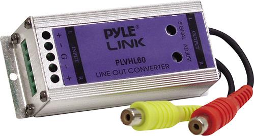

All you need is a RCA jack converter. Best Buy has them for about $5. You wire jumpers from the front speaker wires into the input and it converts it to a RCA jack plug in for your Amp. Then you just wire it in like you would with any aftermarket head unit. I happen to have a sub/amp for sale on the Billboard! Check it out! Haha. Good luck! Lots of good fellas on here with lots of info and experience.

Here's the converter from best buy.

All you need is a line converter and RCA jacks like the previous poster listed. Then you can hook up any amp and subwoofer combination. Plus better speakers like Polk Audio or Kicker would make a difference in mids-highs. Make sure that it's hooked to the front speaker wires, the rear speakers are tuned down in power because they are close to the ears.
