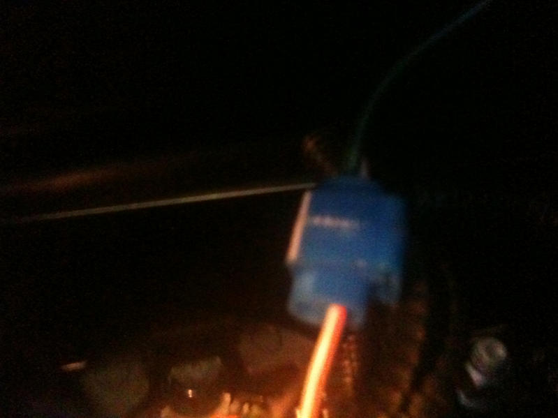

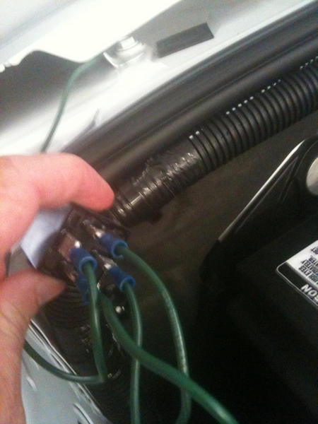

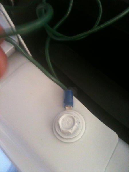

I hooked everything up but it's not working. I grounded each kc with the aft screw of the cowling. I grounded the relay with an existing screw by the battery/hood. The switch is wired to the passenger side fog lights white wire with an orange stripe (I tried the other black screw as well.
Suggestions?
Suggestions?
its possible your grounds are not grounded. scrape some paint so you have metal on metal this may fix the problem. especially if your doing nuts on light attachments and so on.
Okay, I'll give it a shot.
