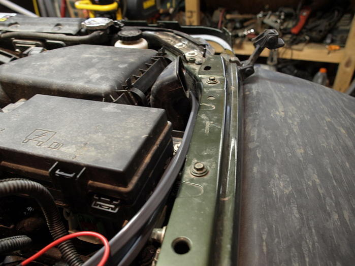

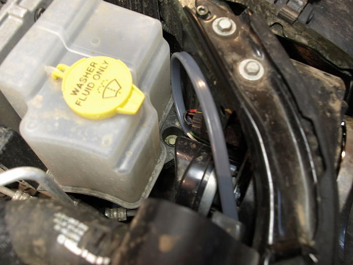

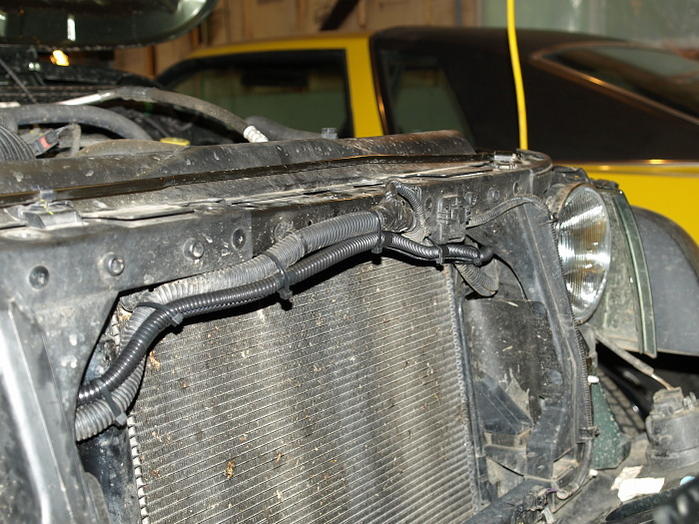

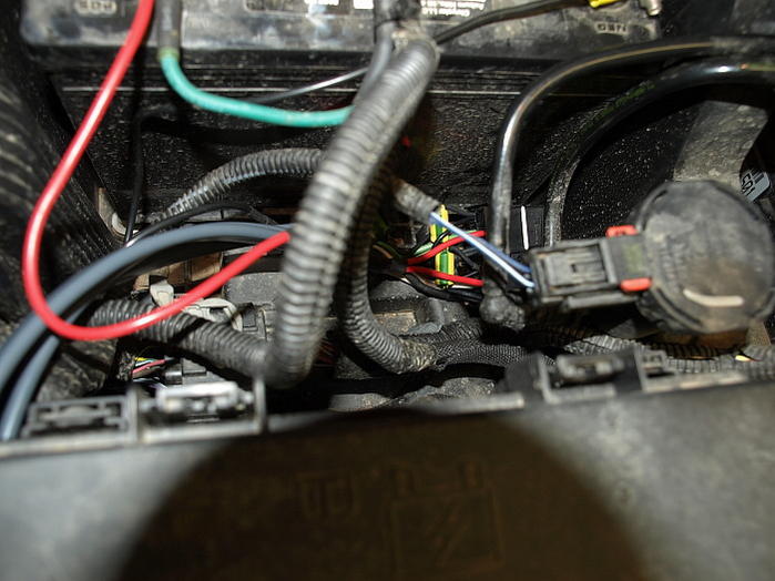

I ran mine along the factory ones. Just have the relays laying next to the battery, don't know where to mount them. I have some of that flexible tubing like what the factory ones have on that will be going on soon.

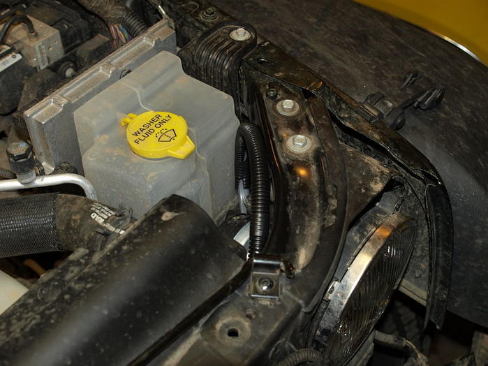

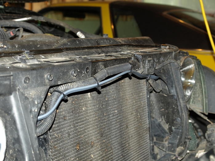

Just finished it up. I don't know if it's just mine, but the factory plug in to the new harness is a bit sensitive. Bend it one way and it wont work, bend it the other way and it works, so if it's not working for you should check that connection first.

Thanks for the pics JB88. I plan to make the switch either today or tomorrow, depending on when I get the Jeep back from window tinting.
