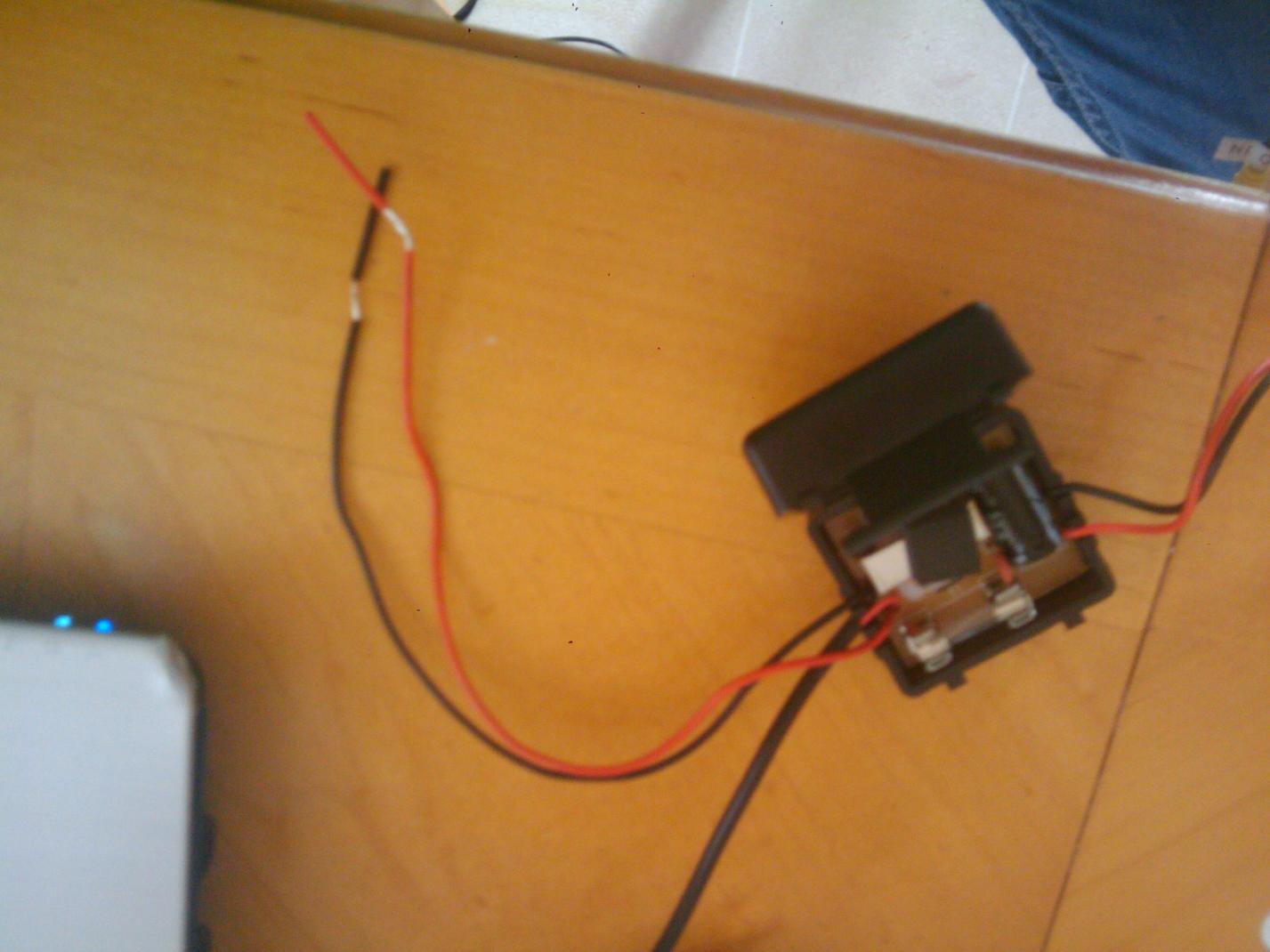

- I have 2 DVD self contained headrest units that need to pull 12v power.
- I want ingnition lit power so I/the kids dont leave these things on.
- Planned to use the Aux Wire Tap for the left aux jack as shown in this Quadratech PDF.
http://www.quadratec.com/Assets/Installation/103381.pdf
Got all the way to the point of getting ready to tap and got cold feet.
Can I tap in to the rear of this outlet for both monitors to draw 12v power without much worry via a wiretap?
The power wires for each of the monitors have their own capacitor/fuse box as shown in the attached pic.
I was thinking I could "Tap" in with a wire tap to the Blue/Pink wire in the back of the AUX jack and run a power line to the back through the console and "Tap" these in closer to the seat backs.
I have also toyed with running a fuse tap from the Fuse box in the front. But, everyone seems to have a different reason for each.
Thoughts? Recomendations? I will be grateful for all and realize this is at my own risk.
Once I get this up and running, I promise a full write up in repayment to the community.
Thanks

Whoops, before anyone asks, this is the wiretap I was going to use.
