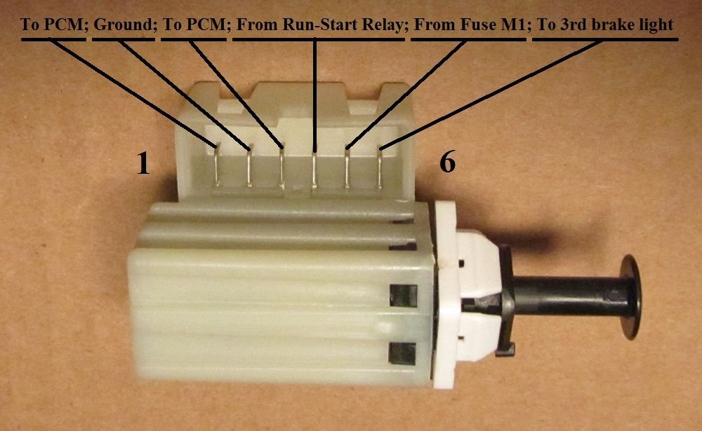

Check socket 5 in the harness for power from fuse M1.
Check socket 6 in the harness for continuity to the connector at the center stop light.
