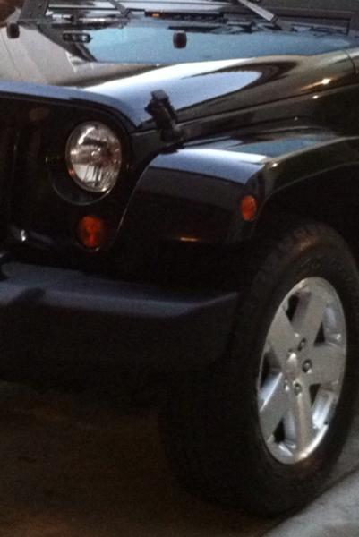

I just added the smoked lenses on mine:
Before:
After:
There's a thread on here, that says it's easier with two people. But I did it myself.
The lens is just sandwiched between the fender and inner-fender.
Disconnect the wire, then pull the fender & inner-fender apart from the bottom, pull down on the lens piece until the top peg is clear. You're on the right track. You've just got to finesse it.
