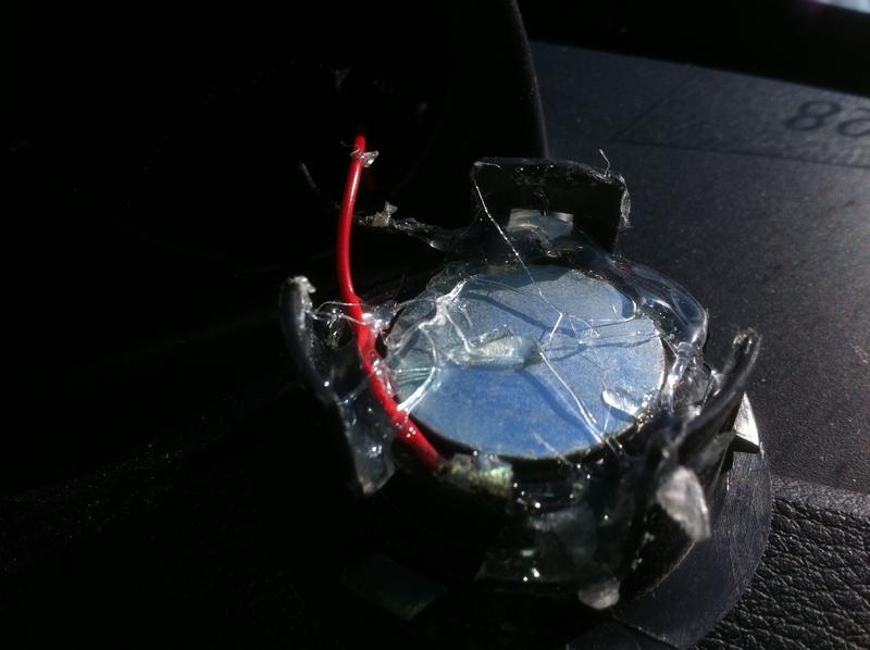

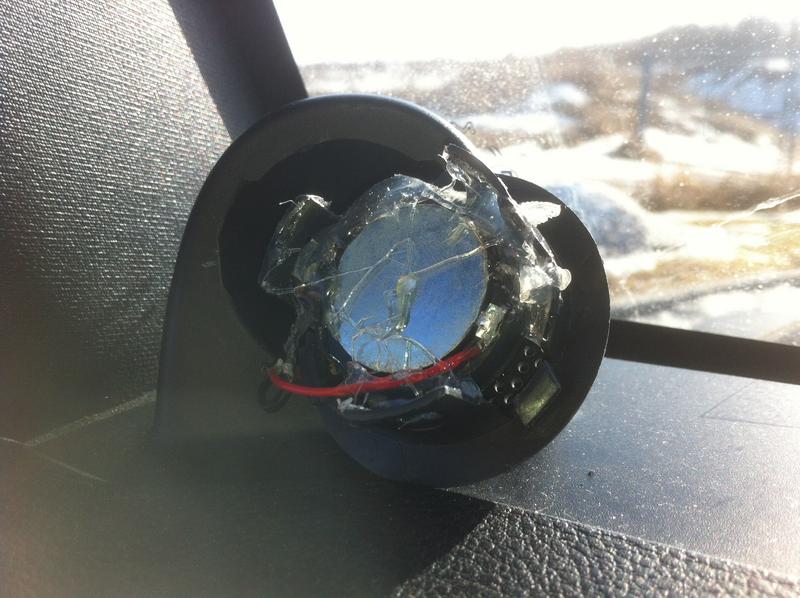

ID:	288263Click image for larger version
ID:	288264Click image for larger version
Originally Posted by fishmd
Any pictures?
here's what i did, hot glued the tweeter into factory grill, added longer wiring to the existing wire that is soldered to the tweeter.
Re: removal, small flat head screw driver, gently pry the grill assembly off, comes off really easy, the factory wires are long enough to connect to the new tweeter.
