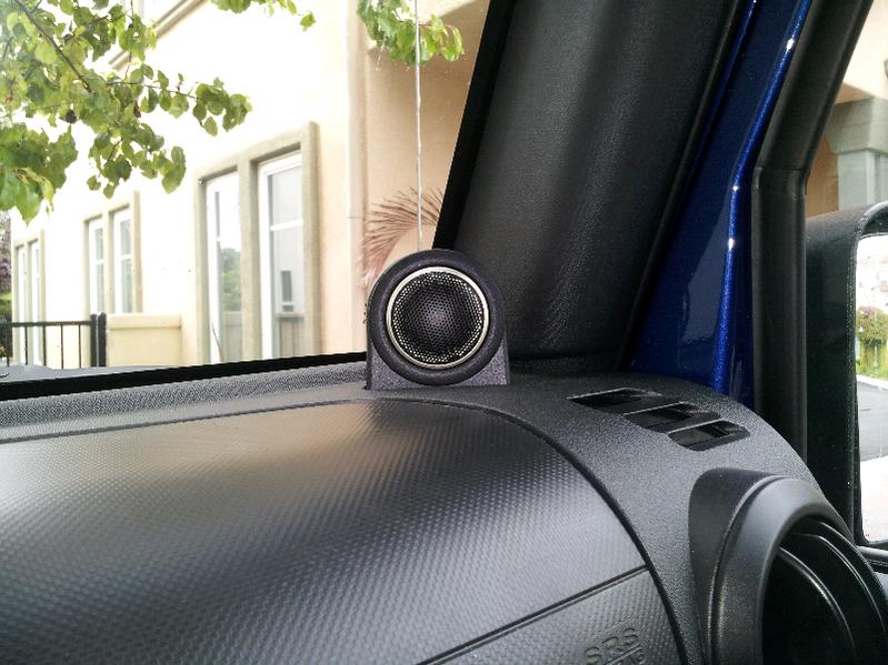

Originally Posted by PANGMAN
Gonna try these Polk Audio DXi 1000 at Crutchfield for $39. Normally $99. Can't beat that price.
Yeah! Finally installed these polks. A Great improvement. Just had to dremel away some of the tombstone and snap in. May add a little glue later if needed. Seem pretty tight.
