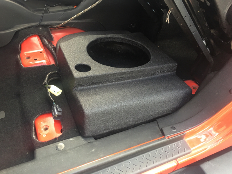

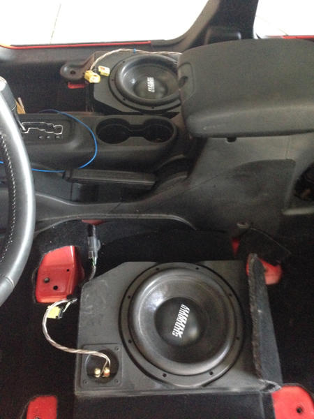

I built a couple versions for my Jeep over the last couple years:
Made these with carpet and Sundown SD-2 10": Click image for larger version
These are Line-Xd and Sundown SD-3 10":
Both examples have internal volume of .6 cu ft. First has a mounting depth of 5", second has a mounting depth of 4 1/2" and is solid Fiberglas with 3/4" MDF mounting ring.

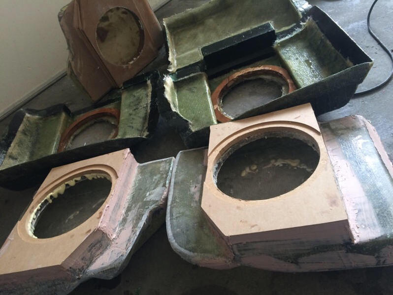

Matt, I'd like to build one of these for my passenger side. Looking through your old posts I found this picture. Are the two things in the front your molds? You then made an upper and lower section then glassed them together? I assume the recessed ring is where you put the mdf ring during the mild over process.
Old May 26, 2015 | 08:28 AM
Mattk11's Avatar
Joined: Nov 2012
Posts: 785
From: Omaha
Attachment 612331
Yes they are molded to the floor pans in the Jeep and extend up into the seat frames. I've seen other people try to do these under seat subs, but their boxes weren't big enough so they were basically mid-bass pods, not true subwoofers or they just built them for 8" subs. It all has to do with the internal air volume. With these 10" Sundowns, I'm getting very low bass in the 23-25Hz range. Honestly I did them myself because my local custom shop wanted $350-450 per enclosure and couldn't figure out a way to get me .6 cu ft and I wanted 10s. In the grand scheme of things, I have dual 10" including the woofers for less money than a JL Stealthbox that ISN'T stealth and is only a single 10.
Choose your woofer and that will tell you how large the enclosure should be. Most 10" woofers need at least .5 cu ft and you have to make them closer to .6 cu ft to account for the mass of the woofer itself. Took me 4 prototypes to get to the optimal size.

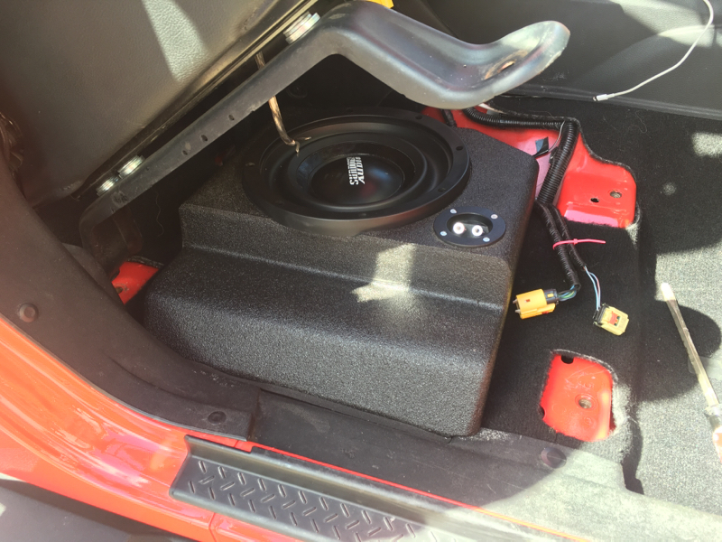

If you have any question, please send me a PM.
I've made some improvements and all are Line-X'd now. I've found that it deadens the enclosure, looks great and makes it completely waterproof. (I know because my Jeep had 4" of standing water in it last Thursday)
ID:	654535 Click image for larger version
ID:	654536 Click image for larger version

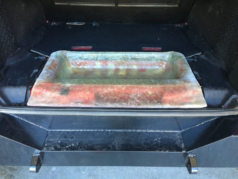

I've also started a project for a rear mounted sub for a 2-door:
